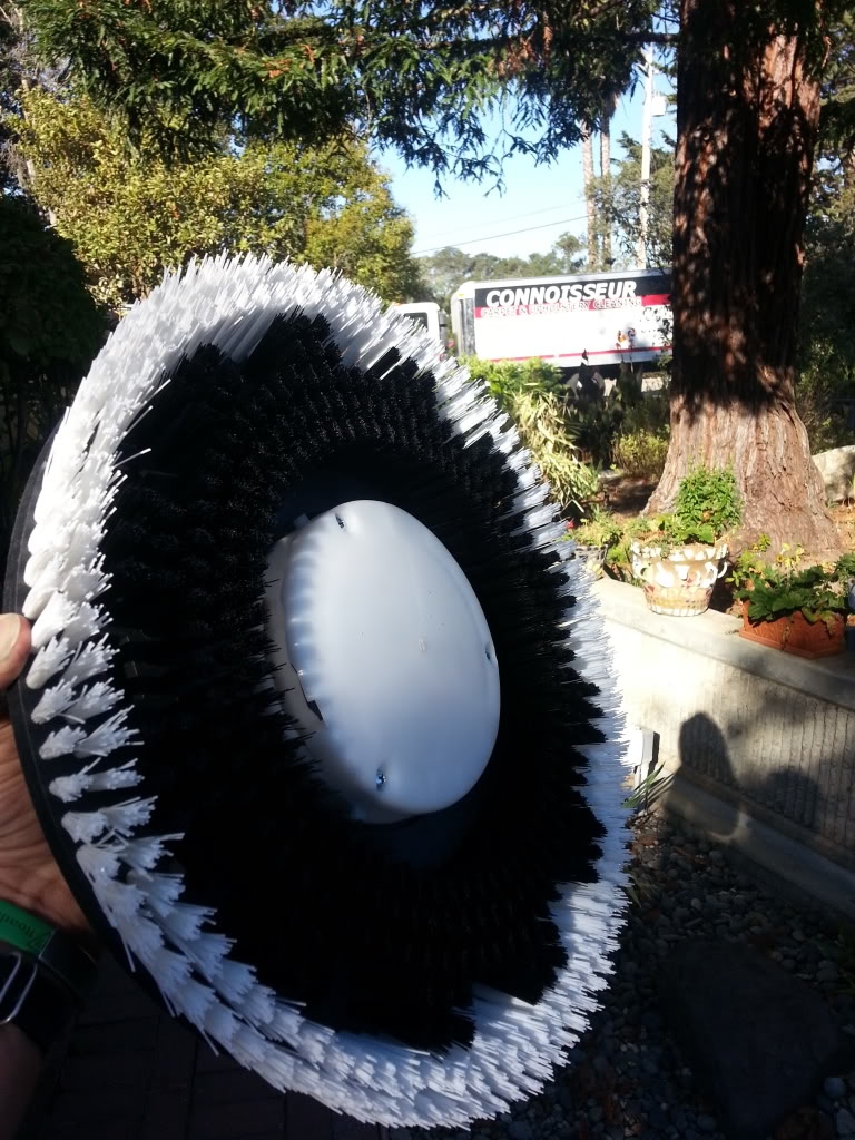

Clean FreAk 175 shampoo brush.
and if you don't have a 1.5 hp 17" rotary on your van, you my friend need to have your noggin examined..
May 7, 2008
8,180
PA
I'm Rick James
Would you use this over a rotary machine like the hoss or 360i? You use it for encap?
114,150
Brent you know those jobs ( about half of what we see, that wont come out GREAT if you don't do something to break loose the soil?
Use a 175 and this brush on piles, or a fiber pad to work the pre spray in real good. You wont believe how well your wand works now.
And when its REAL bad, THEN you bust out the HOSS or Rotovac.
and thats less than 10% of the time for us.
Dont forget we pre vacuum and use well formulated Pre Sprays
and the World's Greatest Suck Mop, Ever.
48,458
Prattville, Alabama
Let me add that I do not have a rotary extraction tool. I tried one (360i) for a week and sent it back. On the worst jobs you can imagine, that brush combined with a high flow, 2 inch wand, at 600 psi (provided you have a capable blower) will, IMHO, clean as good as any rotary tool and leave the carpet MUCH drier.
How is the production rate by doing the two step process vs just breaking out the hoss/360?

Mikey;
While I agree with having a "shampoo" brush . . .
I think the people that use them many hours a day . . .
will use a brush that is more aggressive nylon . . .
and DOES NOT utilize a center riser.
You can take the center riser off, if you already have one.
This is the model brush we use:
http://www.cobbcarpet.com/zen/index.php?main_page=product_info&cPath=69&products_id=2677
For Grout, you need a 3M segmented brush or even better, a cylindrical brush :
Larry
As long as it's broke in good I agree with Larry no need for the center glider.
We would get it balanced, run a stream of water from a garden hose and strap the machine to a pole and let it run on rough concrete for an hour to break in the brush.

Those Centaur machines have some really nice features. I like the idea of the adjustable splash ring and removeable handle the best. I also like the tongue in cheek old Baboushka wearing Russian cleaning lady in the video.
Can the center ring be adjusted based on the type of carpet or pile height? Or is that a non issue? I was told once that you need an adjustable center because the bristles wear down over time and that it can become too aggresive on carpets. Not sure how long "over time" was.. 9-12 months or 6-8 years of moderate use? Was also told you don't want an adjustable center...
ok..who's right Ford or Chevy?
Thanks in advance to anyone who is able to clarify that vague statement.
Bill Morgan
Reactions: Russ T.
Shane T
Nov 7, 2006
1,663
Waukesha, WI
Shane Tiegs
Bill Morgan[/QUOTE
I have the Adjust a Glide brush. The center riser is adjustable, taking pressure off the bristles. As the brush wears down there will be less pressure on the bristles and more on the center, thus it would require raising the center to allow adequate pressure back on the brush. Is that clear a mud?:confused:
