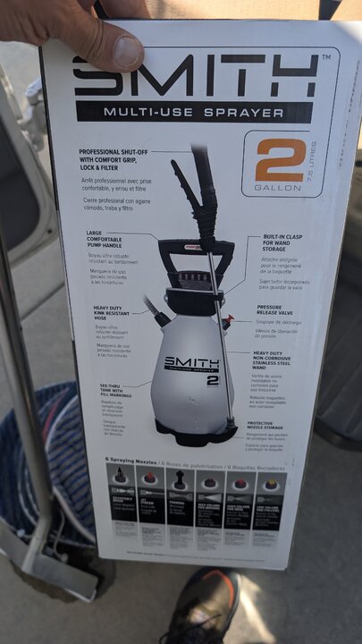

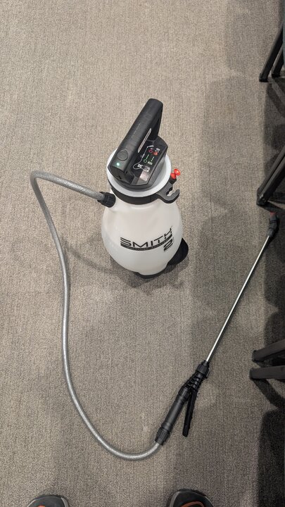

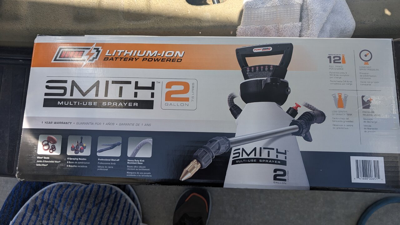

I've used this twice now to pre-spray before running my PHX..
What a joy!
Can't think of a single thing I would change about it
Even the price is great

I have one and it's great for spraying stairs when using the oreck. It's only 20 psi and very low flow. Not really enough to spray rooms unless you have a lot of patience. Reliable so far. Mine is two years old.
What tip are you using?, I didn't have any problem putting shampoo down but I'm not using it to hose down hot water extraction pre-spray..
117,200
I modified it to an 8004 T jet.
I wouldn't look at this as a replacement for the hydro Force where you want to lay down serious pre-spray but rather for what I was using it for and light application of an encap or possibly upholstery free spray or deodorizers or oxidizers...

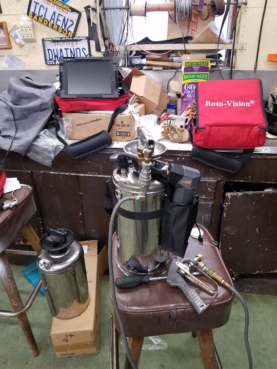

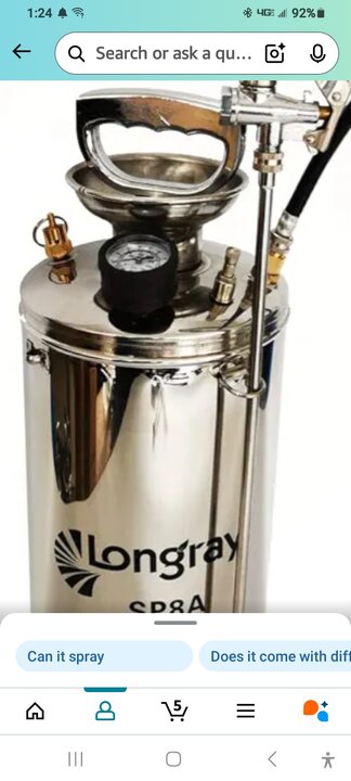

I prefer my stainless sprayer with a 45.00 rechargeable air compressor. Ive been using it for 3 years now and the only problem ive had was i had to unclog the hose connection where the compressor connects to the Schrader valve. But i only use it for upholstery cleaning. I use hydroforce sprayers for presprays and odor control products

I find it perfect for stairs and the Oreck. I use it in the shop as well for deodorizers. Pretty decent sprayer. Could put an 01 jet and it would be great for upholstery.

I got less than that in mine and can inflate my Van's tire with it in a pinch also

On the pumpup side all i did is connect a rechargeable air compressor to an already existing Schrader valve
