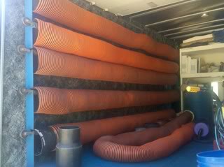

Two? :eekk:
Our small is 8-inches with 6000 cfm.
The video is impressive but the opening to the collection hose is very small. I'm afraid a lot of the lint and debris we remove would clog your inlet.

when its just dry dust etc..and your scrubbing it with the suction just a few inches away...how much do you truly need.
Totally get it for negative air though.
Interesting here, there used to be a bunch of the big duct trucks. Now only 2 companies left and one is up for sale. Bunch have started with the portable negative air and rotobrush systems. City size 250,000 pop

What you don't see is with any agitation system, some dust and dirt flies AWAY from your suction hose, and you just don't have enough CFM with that little hose to pull the dust back to you.
