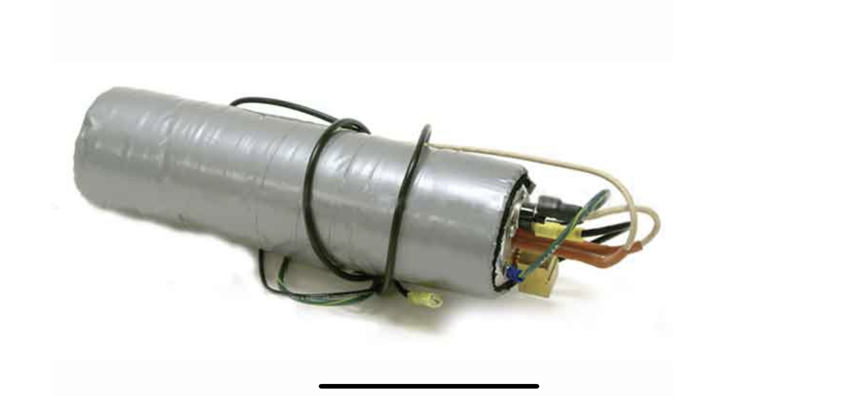

Has anyone ever added one of these to the plumbing of a Cimex or other VLM machine? Maybe a 1000 watt model to avoid kicking breakers or melting cords.
Probably unnecessary, but 140-160f cleaning solution would be helpful on greasy stuff assuming the encap polymers don’t do something weird at higher temps.

But… I often have trouble leaving well enough alone. I was thinking that since the Cimex and Phoenix use such little water flow that a lower wattage in line heater from a portable would have no trouble keeping temps up. And since the amp draw seems pretty low on just one motor spinning there would be plenty of amps left for the heater.
I should have an old, working heater from an old Ninja laying around here or at the shop. I might put something together, just to see what happens.

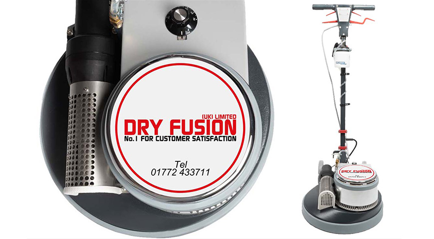

When using VLM and pads you must be aware of HBTP .
Heat Beneath The Pad. The temps can sometimes reach 210 degrees so no need for any heaters.
I know there’s plenty of heat from the friction, but 200f+ is HOT!
Does it really get that hot under there?

I remember those dry fusion from many years ago
And just like that CRB brush machine with a steam attachment , not available over here. Duplex?
