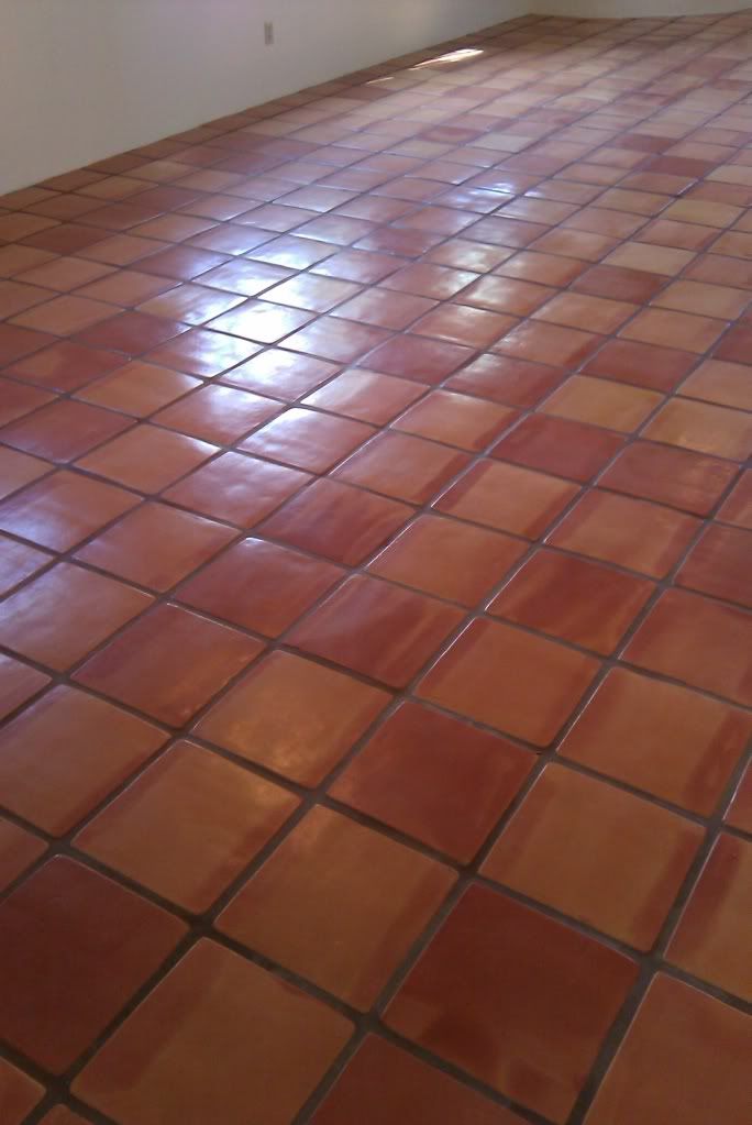

after
another tile job
its been a vortex kinda week.................. :D

Did you use heat when you when you used the turbo? I took a class where I was told heat above 140 degrees would damage the clay.

the saltillio, factory finish with nothing else on it real easy clean up. low temp low psi 125-150 temp 750 psi 890 sq ft at 4.00 a foot 8am to 4pm 7 coats of finish.
quarry tile i think new floor nothing on it when i started so i just cleaned it. and put 7 coats of finish on it.700 sq ft 3.25 a foot about 8 hrs also..
I used judson juice on both floors

the finish i use is ultra chem labs concrete seal. and yes 7 coats makes for alot of standing around time. the first coat has to dry for 1 hr and about 40 minutes for each additional coat. hence the big money. the floor will never have to go back down to the surface. its really easily fixed.

ron i spray the finish on with a 1/2 gallon pump up and micro fiber swifer 18 incher for getting it even. makes for a nice finish.
