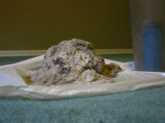

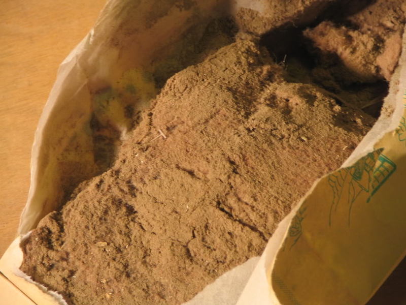

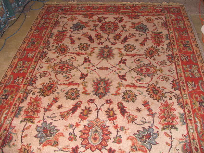

For me I do pile brush and vacuum all carpet to take out the dry soil as possible. Since this is the greatest % of soil and it removes easier dry than wet, this is why I perform these steps.
Here is a clip of a real rug from a real customer, shortened a little so as to not be too boring but hopefully it will show some of the reason to try to remove as much soil as possible dry.
picture of rug, does not look real dirty
PV12 vacuum that started with new bag, showing soil after brush & vacuum
Close up of soil from rug
click on video to play
video showing pile brush and vacuum and what comes out

Steve I noticed you vacuum on padding. I would think this is an aid as to getting more soil out than a flat hard concrete surface correct. Steve you always show a pretty good demonstration.
Stevea
Feb 3, 2007
436
Harry,
Yes, anything that will allow air flow helps with vacuuming. Padding will allow this much better than a concrete flooring.
Thank you for your comments, just trying to share a little and help with showing some of the ways to follow the standards and that proper dry soil removal will actually remove a lot of stuff we as cleaners may leave behind in the wet side of cleaning.

Nice example, Ron, shows the need to use some form of dry soil removal.
Interesting comments GR, I doubt I would use the turbine vac for agitation of pre-spray but since many do not do so, it has got to be better than not doing so.
