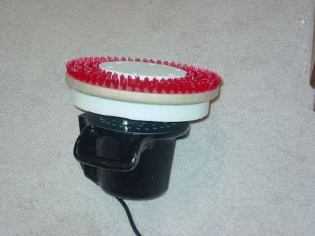

Fred Homan said:
An Oreck orbital works great...12" Very light.....
I saw one of those at my friends ma's house. Went there to clean the carpets and she said I could have anything left cuz they were moving out. I saw the Oreck Orbital and called her....she said oh my daughter is taking that but you can have anything else. I thought the same as you Fred that it would be great for aggitating stairs. She said they were very expensive do you know what they go for? I think her's was called the oreck orbiter but I am assuming that its the same as what your talking about. (white, looked pretty light)
Fred Homan
1,142
I have had mine for about 3 1/2 yrs now. I think I paid about $350.00 Use a black brush head. It does work great! I'm sure they cost more now. Mine is black.

Oreck Orbiter...the commercial model...black brush same as Mr Fred...it is my traffic lane scrubber also...nice and light...and still does a really nice job...it is amazing what agitation will do...especially on stairs...and the nosing of the stairs!
