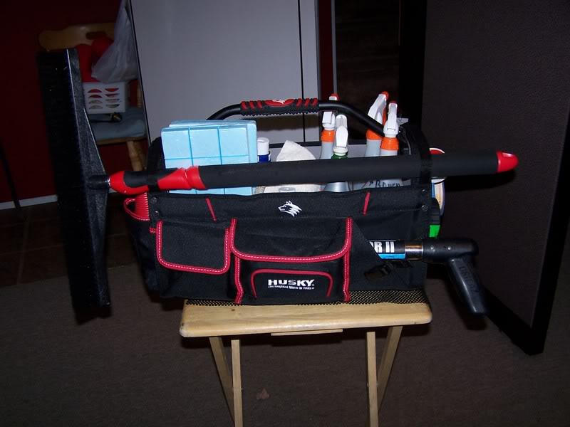

Al
1,310
We bought the handles at the hardware store and ordered the groom heads from Hesco, we have a groom on each AP and one on the carry in bag.
I wanted to cut down trips to the truck

Al,
That's a nice looking carry in bag. A lot better than a 5 gallon pale I've seen some guys use.
