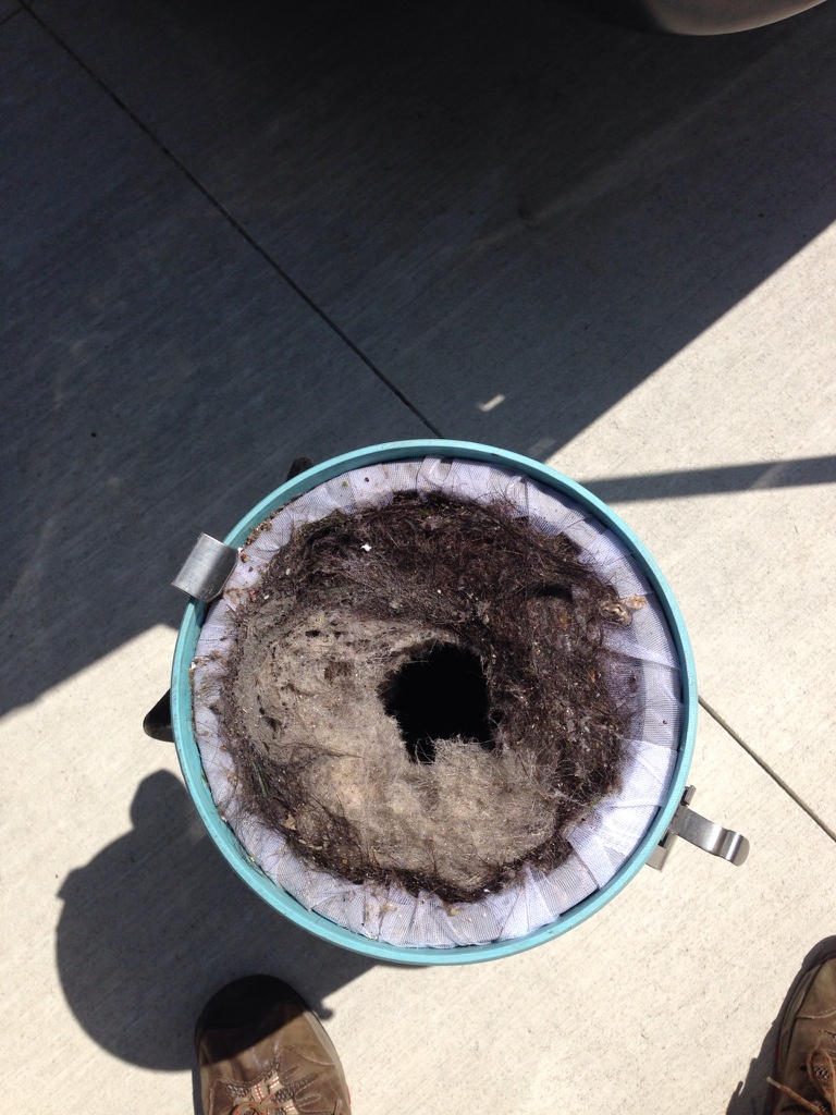

Picked this much crap out of a living rm, hall, office, 1 bedroom today. There is nothing like a good rotary extractor.
Yes, it was pre vacuumed!
11,431
Thats a lot of carpet fiber
Russ T.
Sep 26, 2008
3,556
Russ Terhaar
It was mostly cat hair (2 of them in the home), but yes, there was some loose fibers.
She had a decoration that said "You say crazy cat lady, like that's a bad thing"
11,431
Was that from a 360i
Russ T.
Sep 26, 2008
3,556
Russ Terhaar
Yes, with the standard 3 head. Been thinking about moving to a bigger RE as I use it a lot. Only a year old and don't want to lose my shirt.
It works great, just slow.
