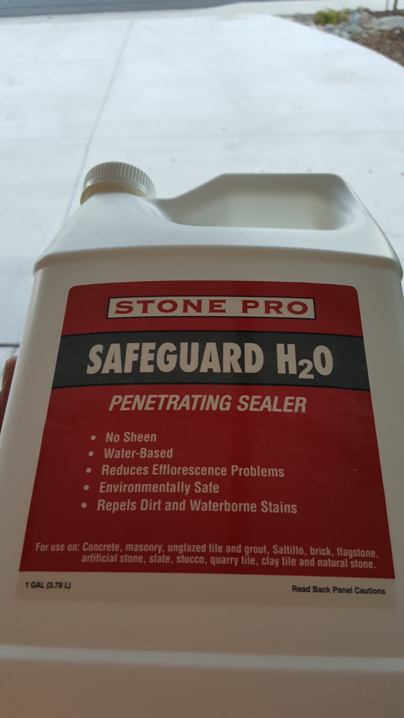

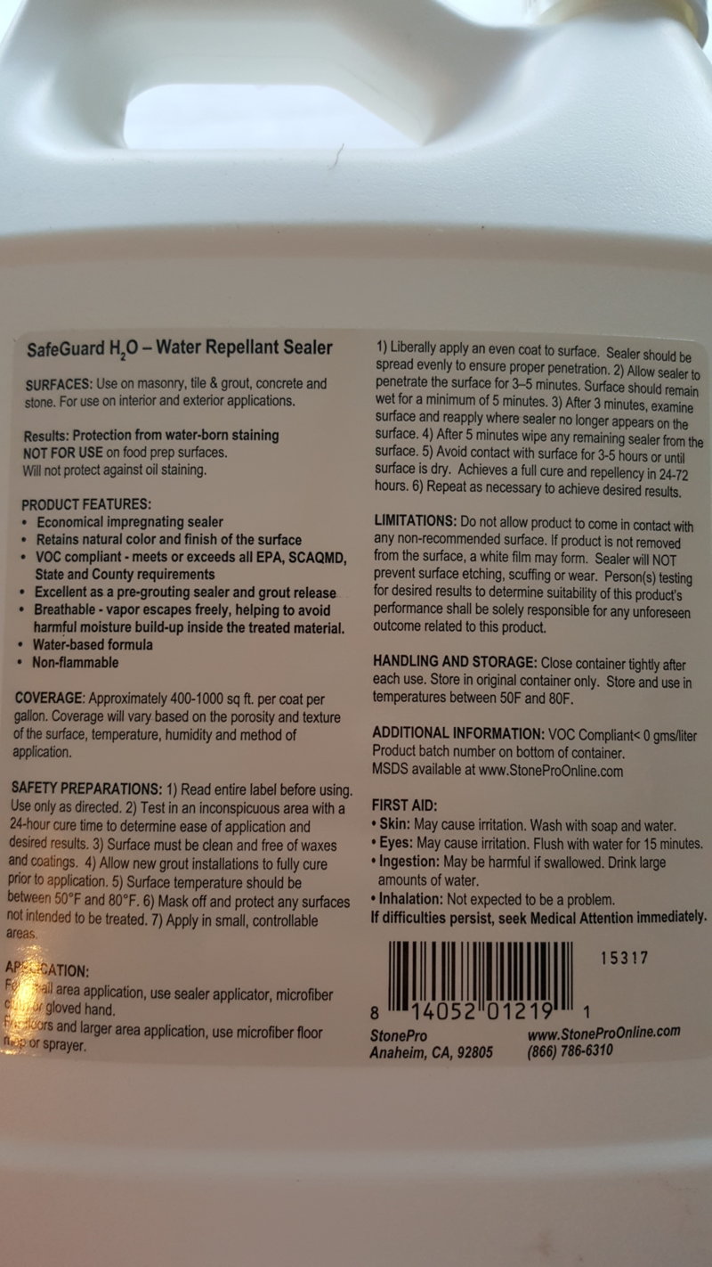

I tried a popular solvent based that did less than zero to seal my drive way..
This suff on the other hand..

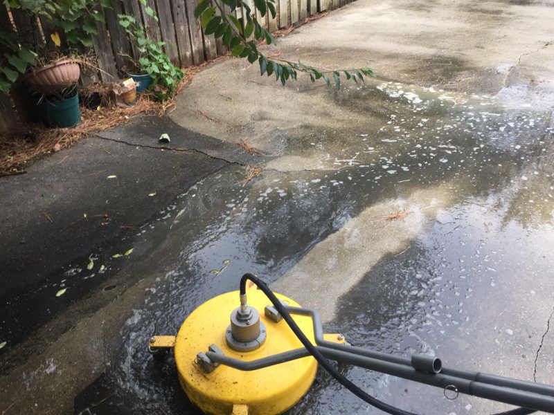

I just cleaned the Original Hellish Driveway. Might be a good upsell.
