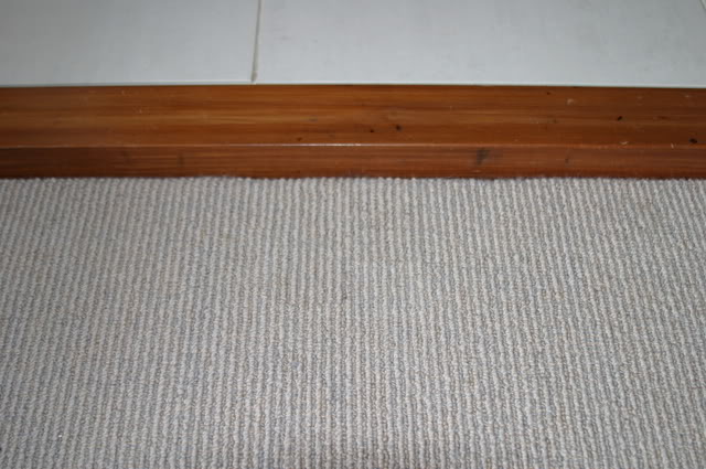

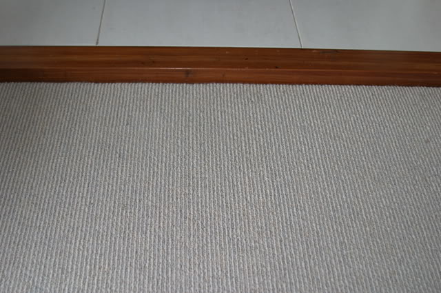

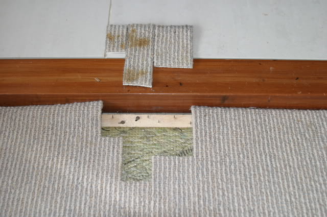

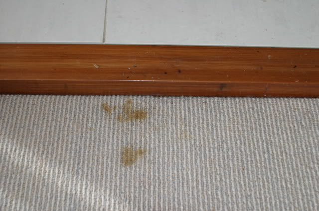

Being our winter, I do a lot of burn repairs at the moment.
Here's another that I did this afternoon.
There was the main scorch mark and then a number of small spots around the area outside of the photo. I did a combination of re tufting and grafts for those small spots and then did a full insert for the main damage.
Again, notice the different cut, trying to break up the finished lines so they are not as obvious.
There was a little colour difference as this section used for the donor had not been out in light so I had to colour the donor lightly to blend.

John another nice repair. This is what I have noticed. Why with a product that can last for many years . do they use an inferior cushion. What is the weight density. 6lbs 8lbs or 10 lbs. I ask cause in the states it has to be aa min 10lb rebond or a synthetic felt cushion. It could also be a 80 oz or more rubber or a slab rubber cushion. These all have great density. Rebond should not be used for that application. Just Asking.

Wouldn't have a clue on that side of things sorry.
That happens to one one of the better foamchip (re bond :lol: ) underlays (pad :lol: ) but I'm not up with the layer standards for NZ.
But I will say this, that is a typical installation here.
Another gripe I have is the retailers using "FREE UNDERLAY" in their marketing sales and then putting the cheapest nastiest stuff under coz it can't be seen :twisted:
I'll make a few enquiries and see what I can dig up for you. I've been thinking especially because of my Inspector work as it develops, that i really could do with a copy of the Standard for installation so that I can check/clarify these issues.

What I am impressed from that picture is the gully . It is correct . Allot of people in the states put it to far away from the wall. It at most should be 3/8 of an inch from the wall. John and your absolutely right standards are for reasons. I would think and hope the New Zea land wool Foundation would have high standards. There wool is well you know. :p
John Watson
2,885
John and Harry, Not only is the gully correct, but, the installer, or probably his helper while stripping it out miss hit the nail.
He needs a Medal, He added another!!!!

John, those marks are scorch marks on the timber surround!!
Harry, I have heard it taught that the gully should be approx 2/3 of the thickness of the material being installed.
That is what I aim for anyway, and never have trouble with the carpet not staying in there.

John I said I was impressed on the gully size. Unlike in the /states People usually go the thickness of there fingers. I was implying that what I saw was correct and glad to see so Mate. You are my mate. And there is no criticism John. I was impressed and still am
John Watson
2,885
John, I am yaking aboot the 2 knail heads in the tackless. One can see that one is bent and then flattened down. What I was commenting on the hammerer knew he screwed up and added an other knail to make sure the tackless was secured.....Aye, You sure ain't from Canadia??? :lol: :lol:

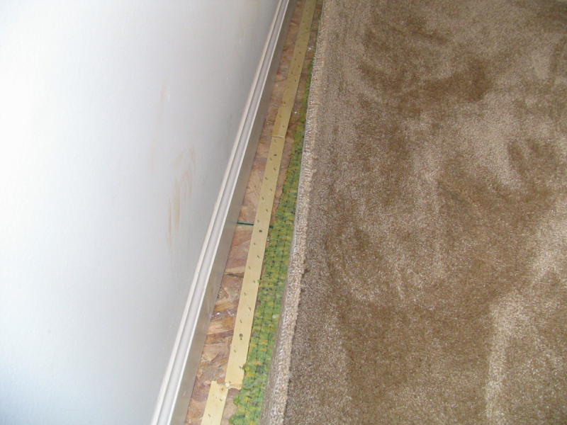

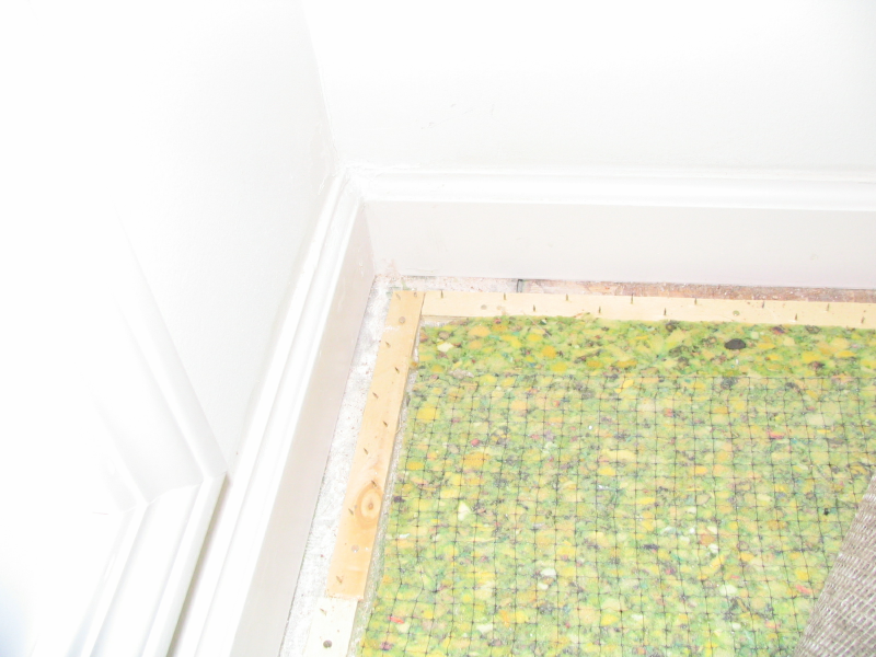

Here is a gully from an inspection where the consumer said the carpet would not hold. Think this is too wide?
Here is another one that is too wide
This is what is done a lot in installations, no wonder the stretch does not hold.

Wow Steve nothing will hold with that gap looks like the carpet installer thought due to the thickness of carpet he had to make it wider luckily for you it is on a wooden floor.

Quite common to see this, no one wants to put the right gap in a gully it seems. Wood floor is nice to work with in this situation, easy to correct.

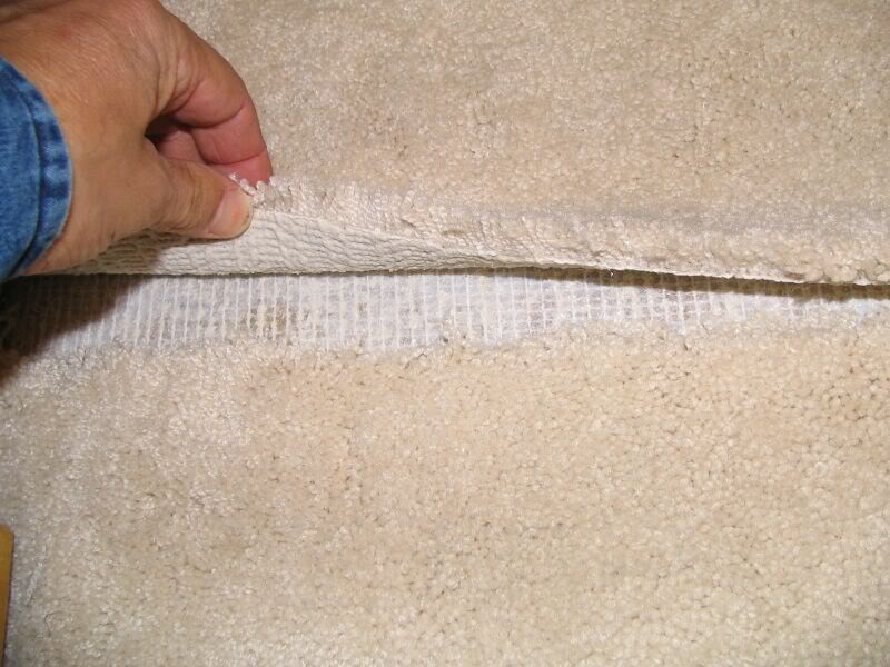

Here is one I looked at yesterday and may possibly do the correction on it but I never know for sure, had I had my tools with me I would have just repaired it while I was there but I was on my motorcycle doing inspections and just did not carry any repair tools.
Here is the bath area and there are two seams, one at the door and one where the pen is
this is the seam at the door with the delam
here is the seam where the pen was
Very simple to repair but the consumer is wanting new carpet. I never know what will be done but this is common stuff along seams.

Yes, I would have used hot melt but I use different than what is bought at a hardware but yes, hot melt. The seam tape was still in place so there was not a reason to take that apart. Seal edges(with the same hot melt) and laminate it and it would hold great. Very easy repair as most delamination repairs tend to be.
