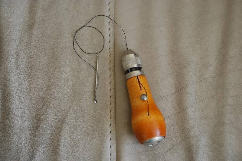

No NEEDLES !! Guess what this for?
Roger Koh
Leather Doctor® System.
