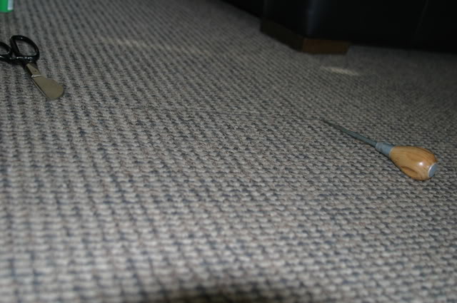

Inspected this job yesterday and I have to decide what to recommend.
4 rows by 1-1.5" long where the rows are totally flat without any height variation.
Being more than 1 row wide, and so long, I'm not game to suggest a total re tuft, however, my gut feeling is that on the cream only, periodic tufts removed and re tufted lower would do the trick.
They are extremely cautious regarding any sort of graft or insert. It's on the edge of a walkway so my concern is that if I grafted it, it may 'feel' stiff under foot.
I'm not sure an insert is correct either because the existing joins are rather obvious from minor peaking.

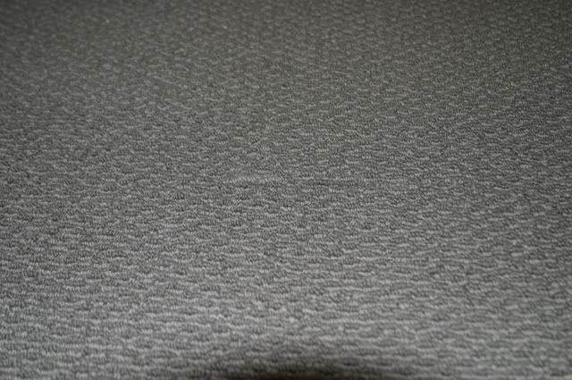

Here's a small Camavier Bremworth claim I did about a week ago.
Tension problem. 2" of the lighter colour raised too high the next 2" too low and not visible.

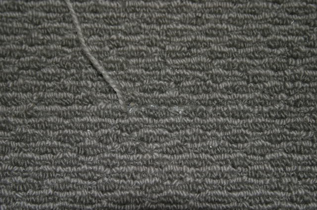

Problem tufts removed.
Half way, not as pretty as what M can achieve, and no you can't see my custon designed needles :wink:

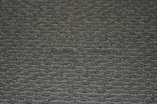

Finished. As good as I can get it. Looking closely, I don't have enough variation of height, but I'm still learning. Standing back, not visible.
