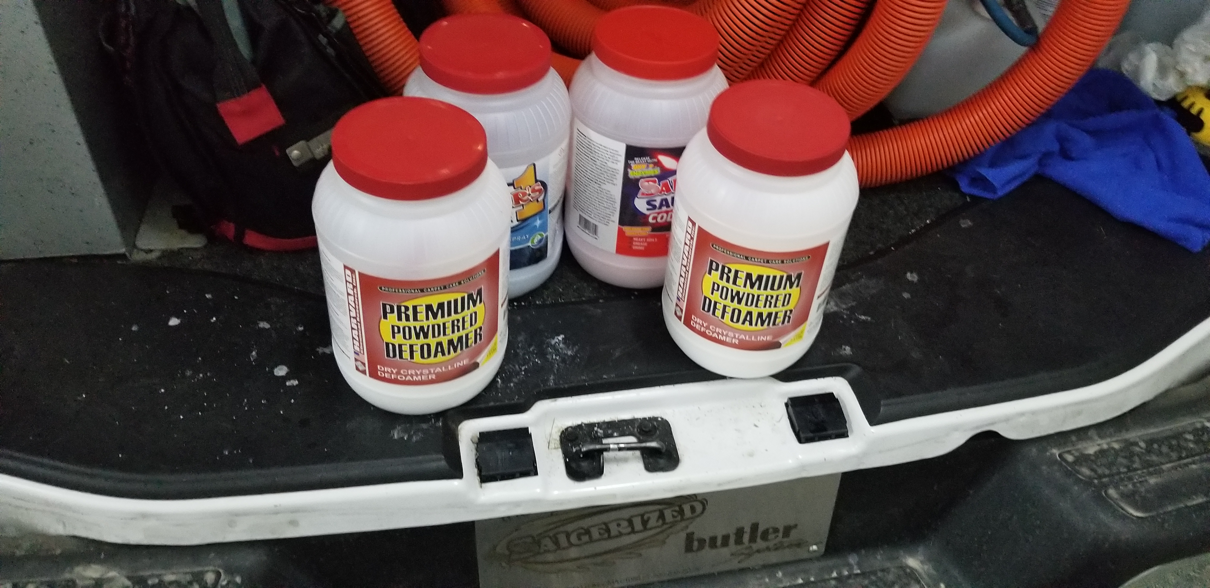

First job this morning notes
renting minimum service call
2 year old squirted dish soap on carpet
Prepping van for the battle. I can usually carry a tub of defoamer for about five years...
Not sure about today....
