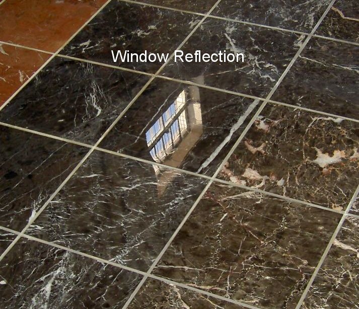

The class that Wayne put on was definitely "hands on" as several customers tried different techniques on the 4 different stone surfaces.
This is a photo I took of the dark marble after "Cheetah" polishing:
Good definition on the window reflection.
Larry
