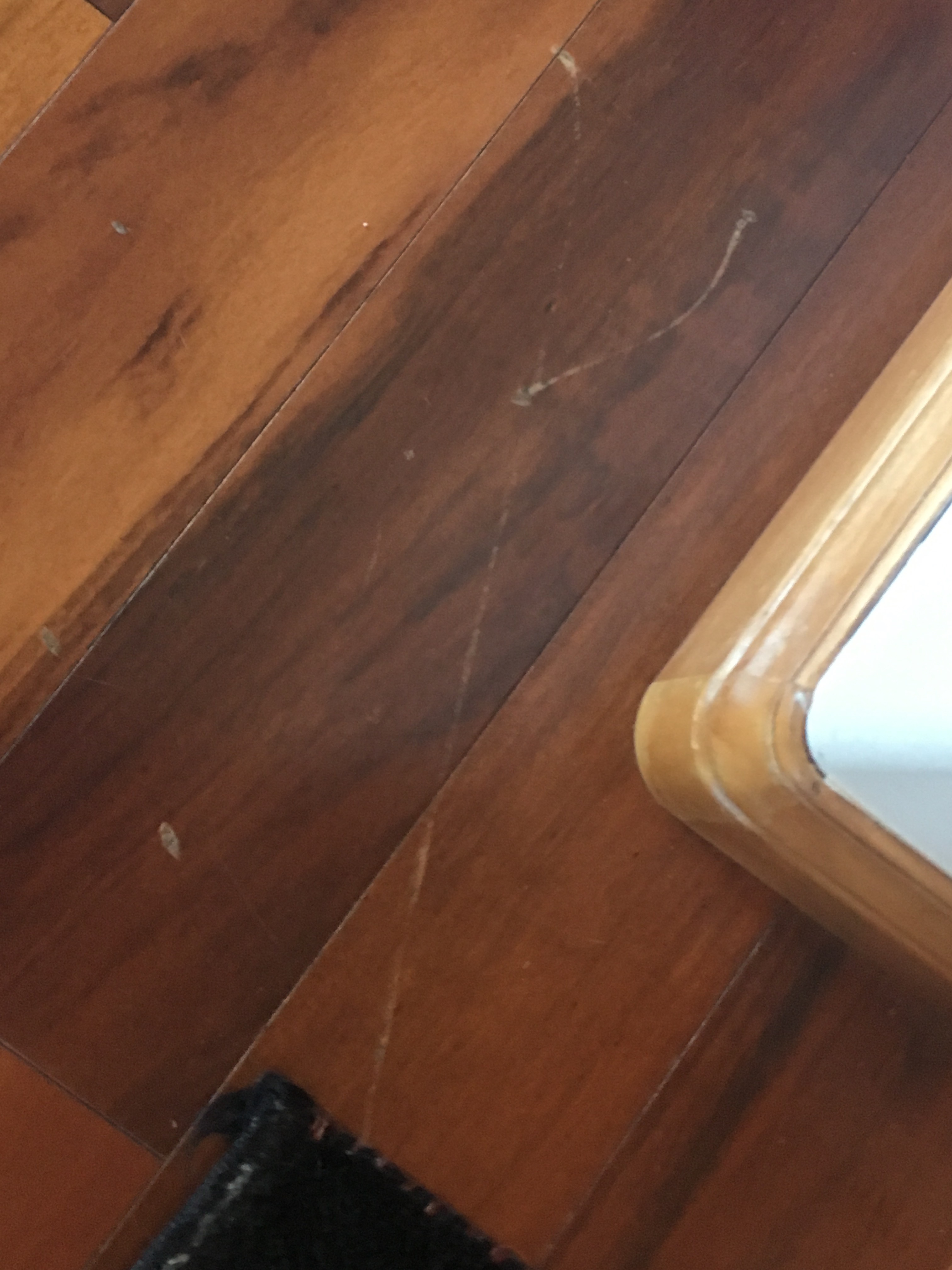

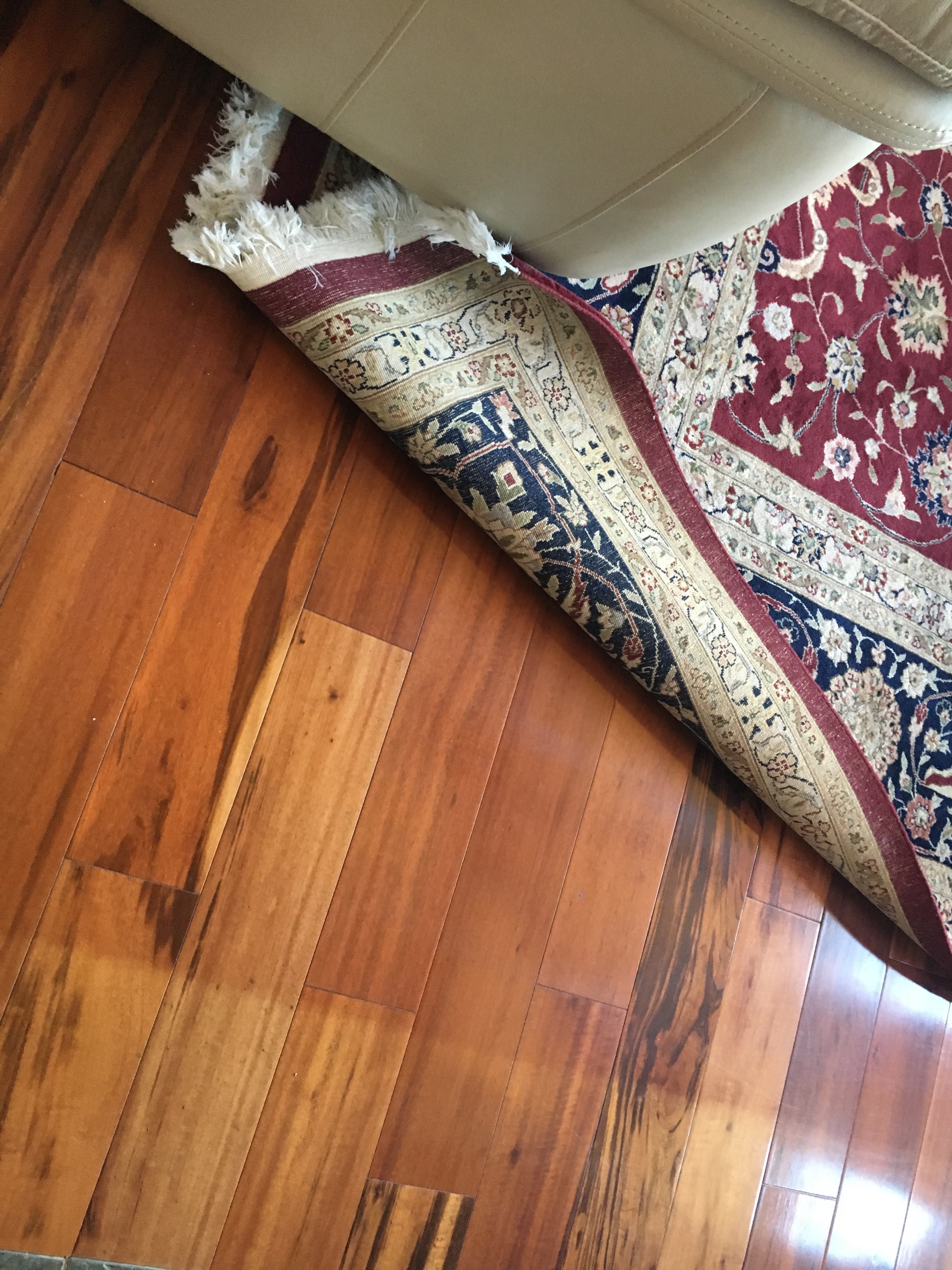

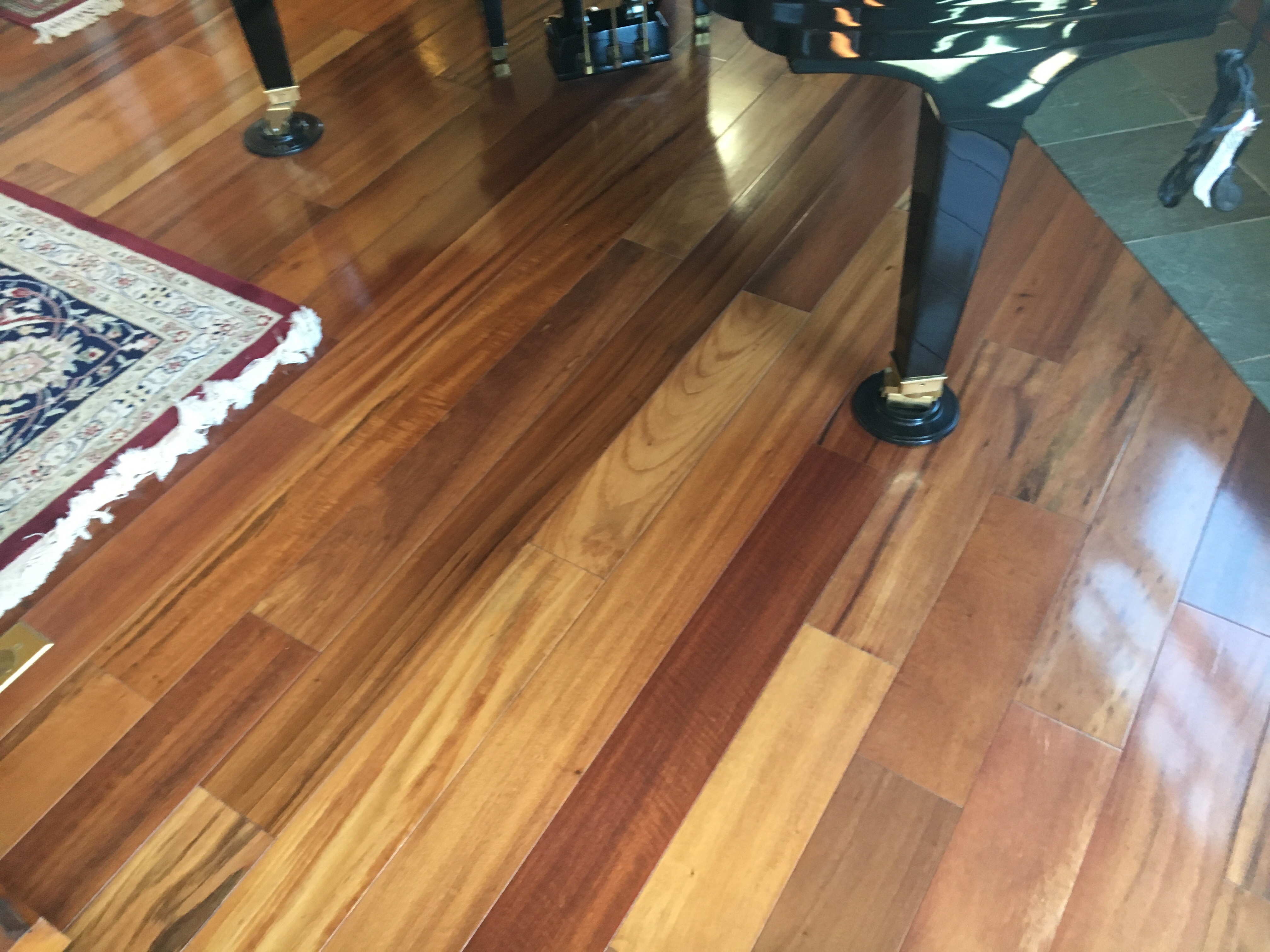

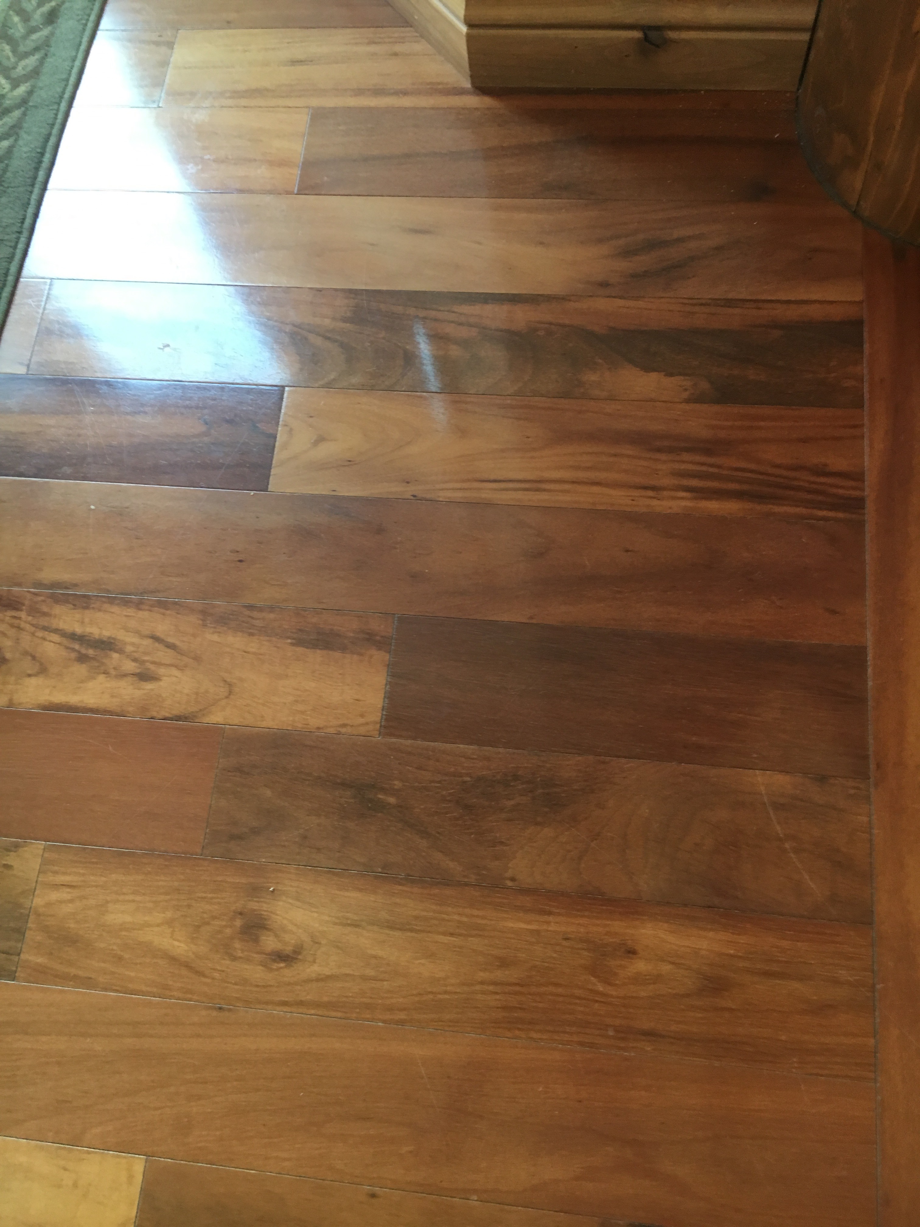

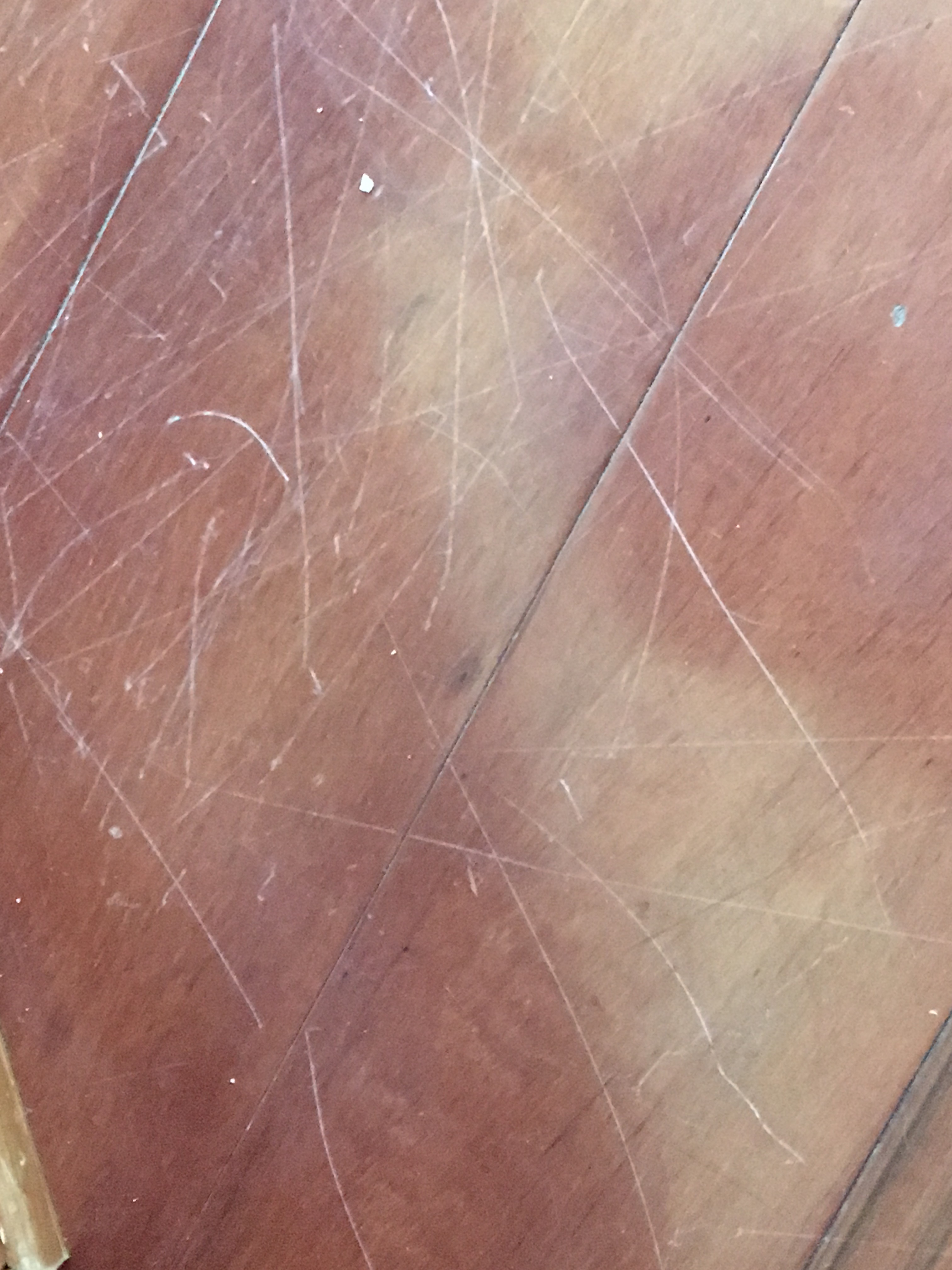

these folks are moving in to a new home where the wood could use some work. They requested I come out and "Buff and Polish" and specifically asked for it not to be sanded.
between the fading and scratching on this AO finish, I can't imagine them being happy with the results of cleaning and a white pad.neutral cleaner buffing...

Did you test for any mop and glow crap on top? Do those big scratches look like they’re deep in the wood?
14,646
And if they requested no sanding/screening, then the Tykoat/streetshoe gloss method is the only way to make it look more presentable.
I called Basic yesterday after reading your links on AO and asked them if their products will bond to that kind of finish and they said yes
Yes it can be scrubbed and recoated. Yes the deep scratches will show through the new finish in the right light. Yes any color shifting will also show through.

you can try some Old English scratch cover.
It doesn't make 'em go away, just puts some color in the scratch so it's not as obvious
and draw the blinds.....
no clue how you could fix the fade
