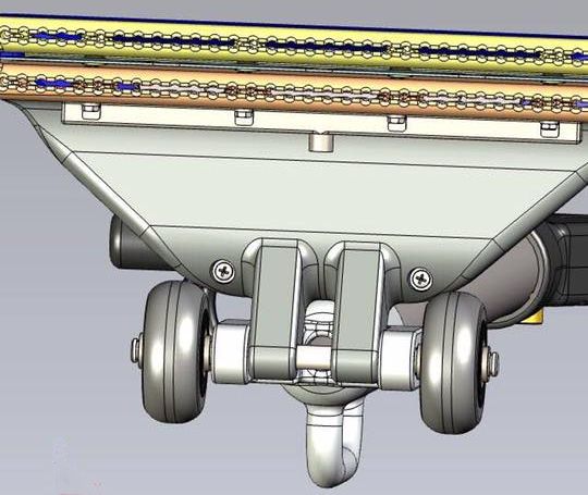

If THATS what the underside looks like-- ERIK has nothing to worry about!-- the bonzer would be better then this knock off!
Did you notice the spray jets are after the 2 vac slots?
This wand will be DOA (Dead on arrival)-
or #1 best seller on other boards. :eekk: :dejection::stir:
116,449
Looks like there are jets between the glides as well.
8 flow and a 24" vacuum opening, won't run off any portable or ETM, that's for sure.
There's those metal glides again.
Are those still rooted out of losing the Harris Research lawsuit or the thought that some extra agitation is good?
I'm not giving an employee a very potential stone, wood and baseboard damaging tool.
No wheel height adjustment seen but probably not needed with the two shoes so close.

Unless those are not (4) jet behind the glide, this tool should not be used in the manner of the Zipper (long full room wet strokes) as the water from the back jets will not be recovered quick enough.
Larry did Shawn Forsythe have anything to do with the design of this?

If there's jets in between the vac slots, it won't have enough time to flush out the soil. The water needs to get under the soil to flush it out. It looks like as soon as the water hits the top of the carpet, it's gonna get sucked right up.

Mytee says the spray is fully contained so I'll take that to mean those are not jets on the back side and that rendering has been changed.

Ya full back wards and forward cleaning not possible with exterior jets.
116,449
OK I think see whats going on there, that spray bar has flood jets going forward and spraying down between the glides.
Which means the vacuum port is obstructed at least 4 times

All that said let's continue to speculate on mytee knock off as it seems like the "leak" of the yet to be released or shown wand is getting the word out effectively just as they might want.
I think the tool has two jet bars, one will activate or spray going forward And other will spray going backwards.
Just a hunch we will see.

I just got off the phone with John L. of Mytee .
=There is a single row of 5 jets between the two vac shoes (Erik the same-edited).
There are PTFE glides on both vac heads.
The PRO vac manifold stainless design is based on the Bentley wand,
with a similar air channel for the second head . (no air gap on back head required)
The Bentley PRO comes with a flow control to adjust the water flow to match equipment.
Hundreds of carpet cleaners will actually demo the equipment @ ICE in 10 days.
