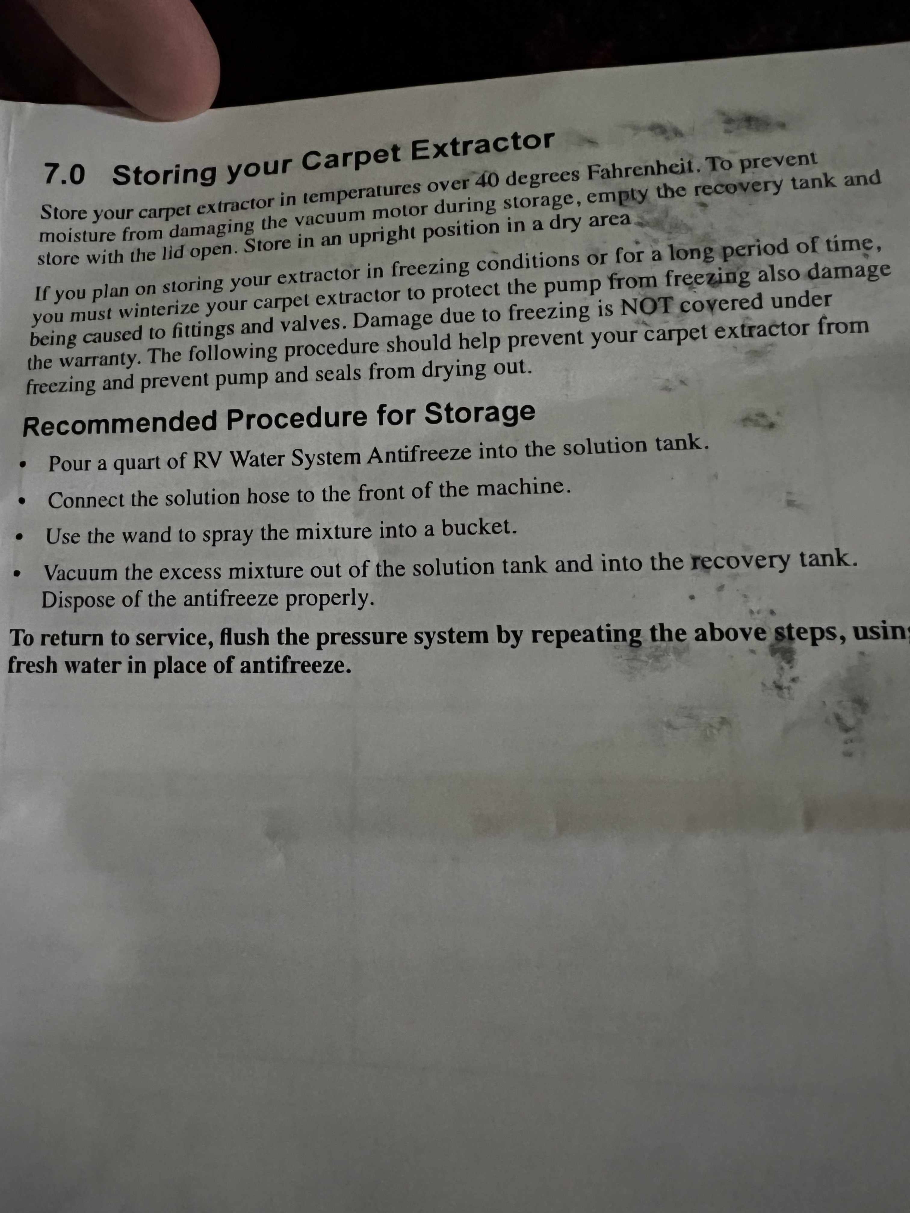

I'm taking my RV in to winterize it on Wednesday. I see they use a shuflo pump for water in the motorhome to pressurize the system.

Joe Gingerich
Straight out of the Sandia manual.
