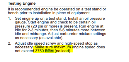

Which is closer to full RPM? 3000 RPM when max RPM is 3750 or 2000 RPM when max RPM is 5000?

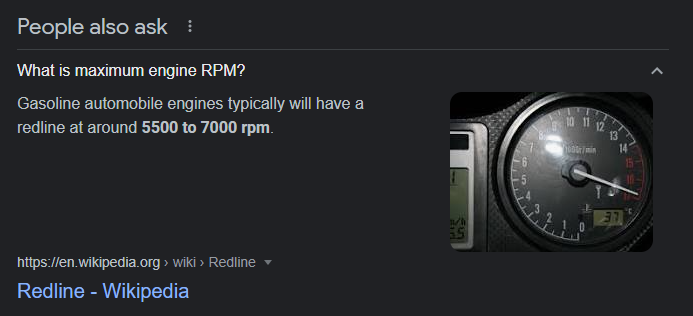

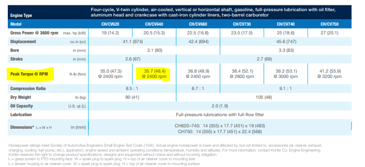

The point is it's running at a much higher percentage of max RPM. 80+% in the example. Industrial engines (most) are specd for power at a much lower rpm. Also the sweet spot isn't usually at peak rpm (curve starts to flatten)
Cars generally aren't run continually in the upper rpm range of 5k+ (80% of redline)
and on a car the fan is pulling/removing heat from the radiator coil....not so much providing cooling for the external components.

All of that has to be taken in consideration when calculation when figuring out what RPM to spin the motor. And as Fred said, these motors are already spinning over 80% and peak hp/torque is never at max rpm 🤷‍♂️

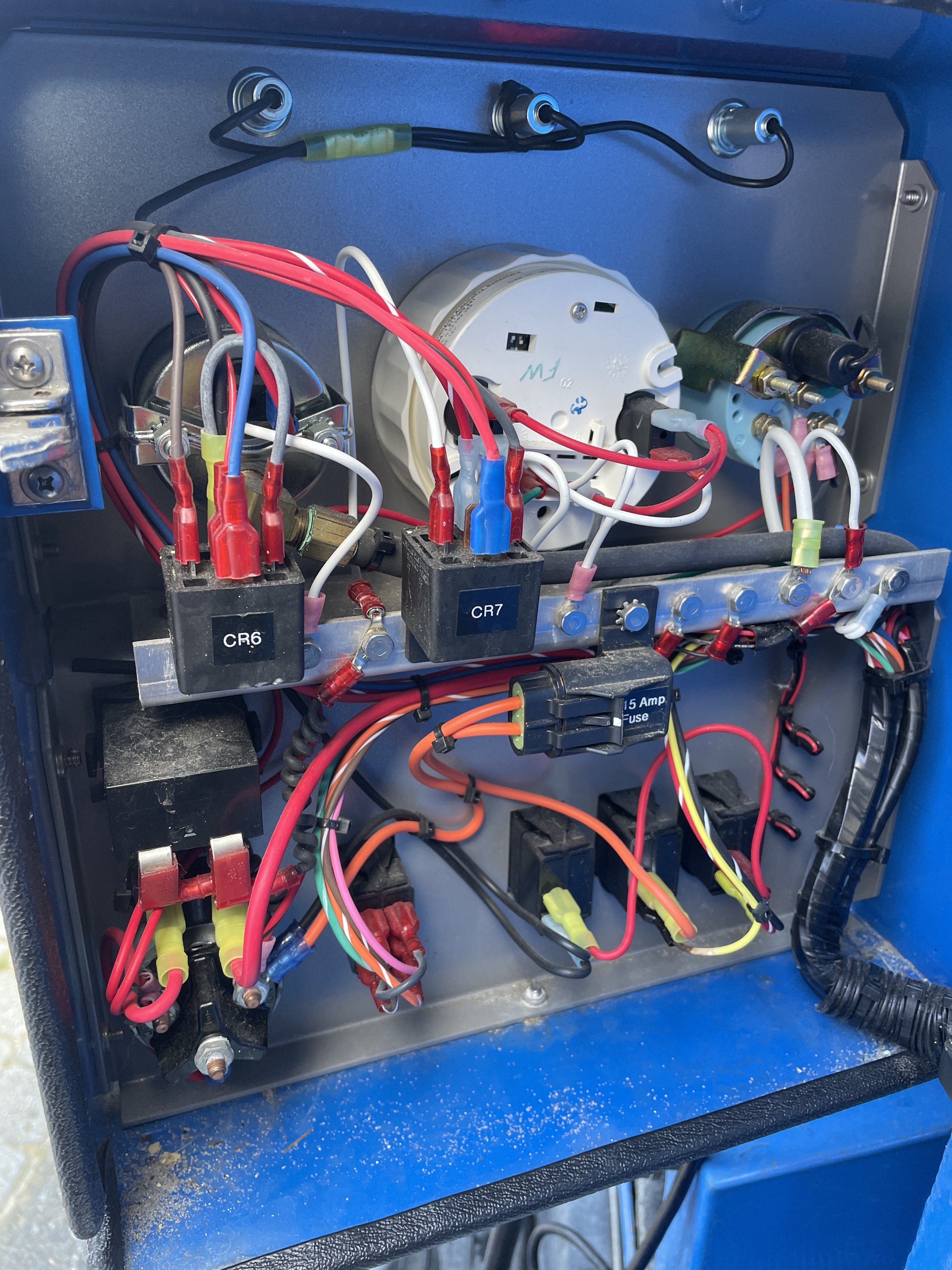

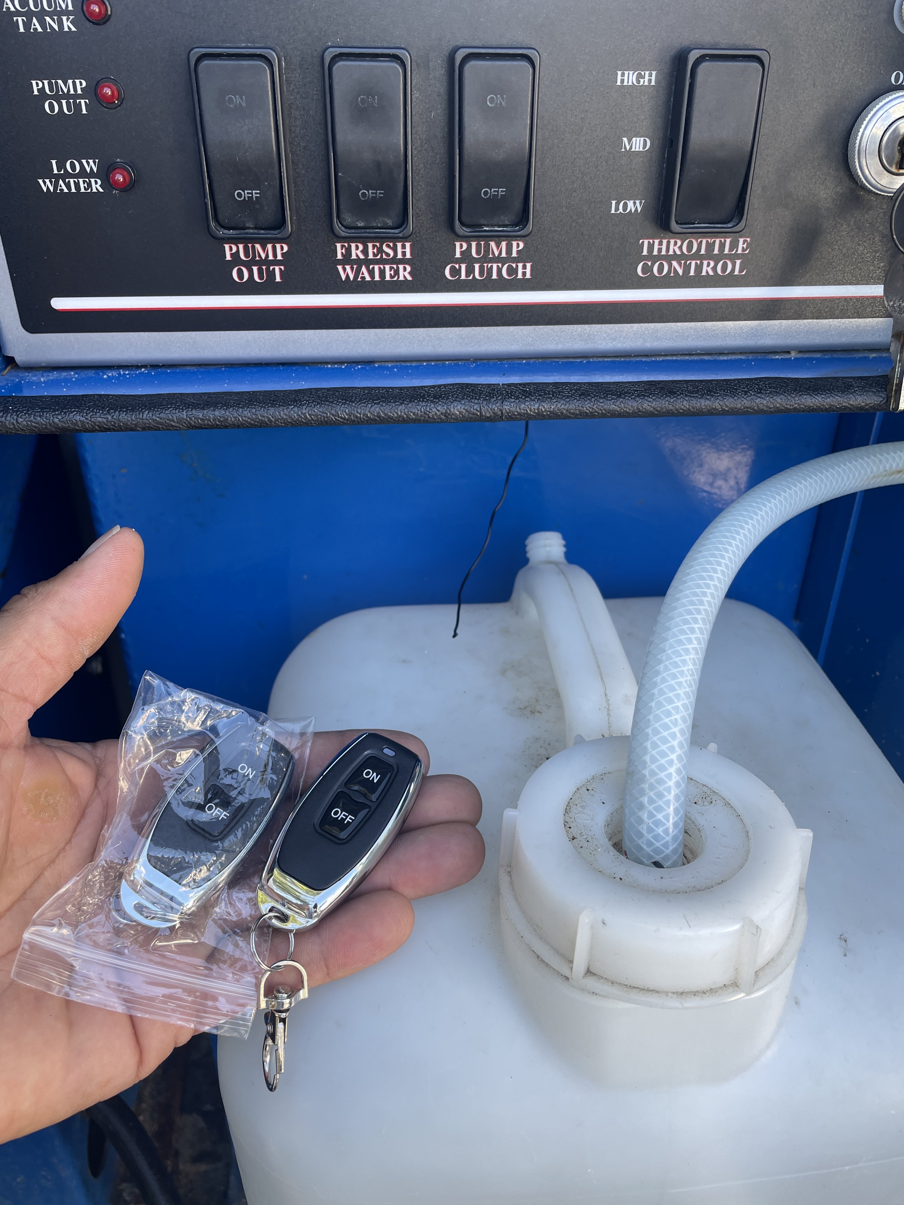

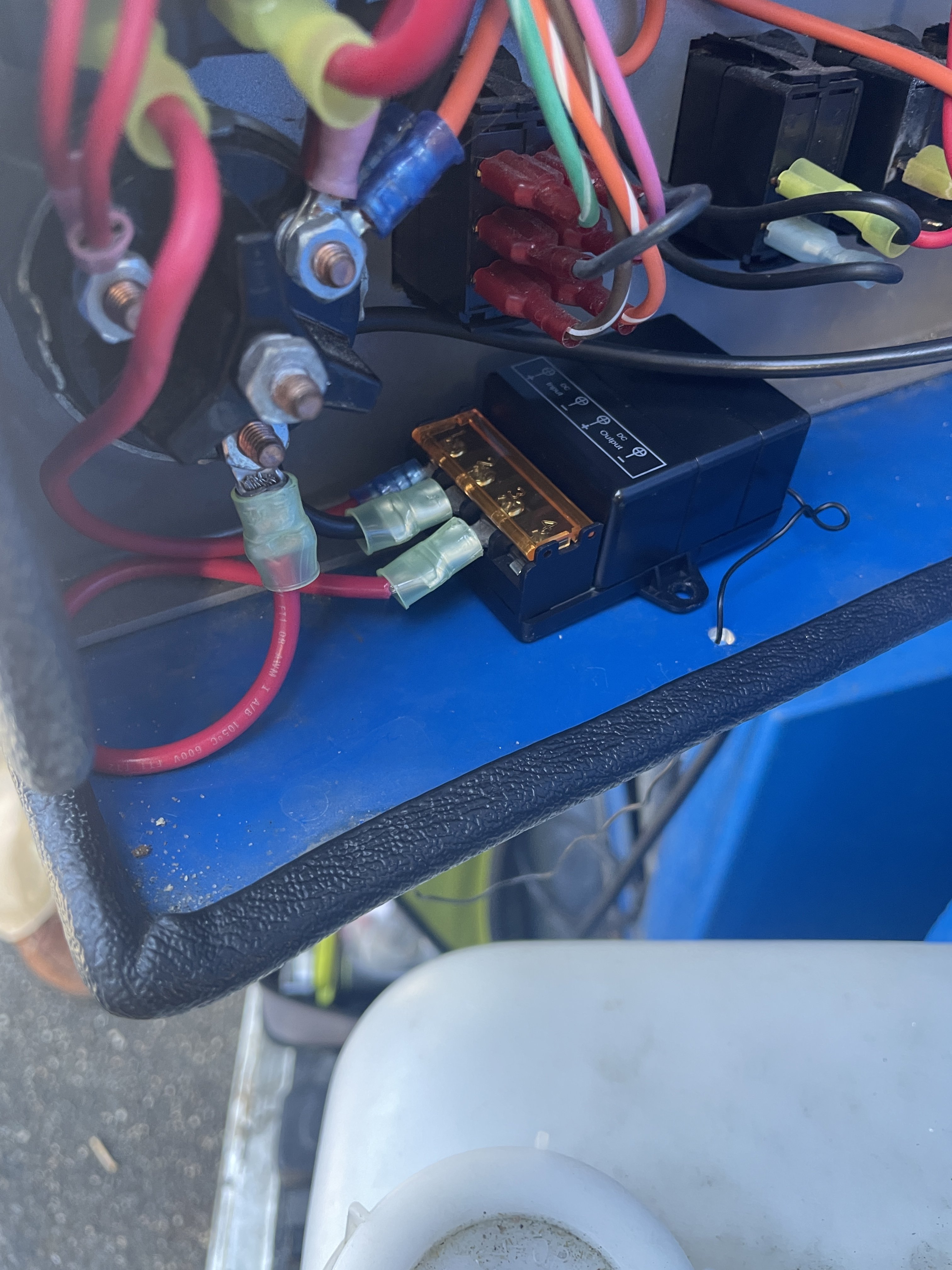

All Done.
Before
After
Remotes with the antenna dangling
Running
Totally stoked.

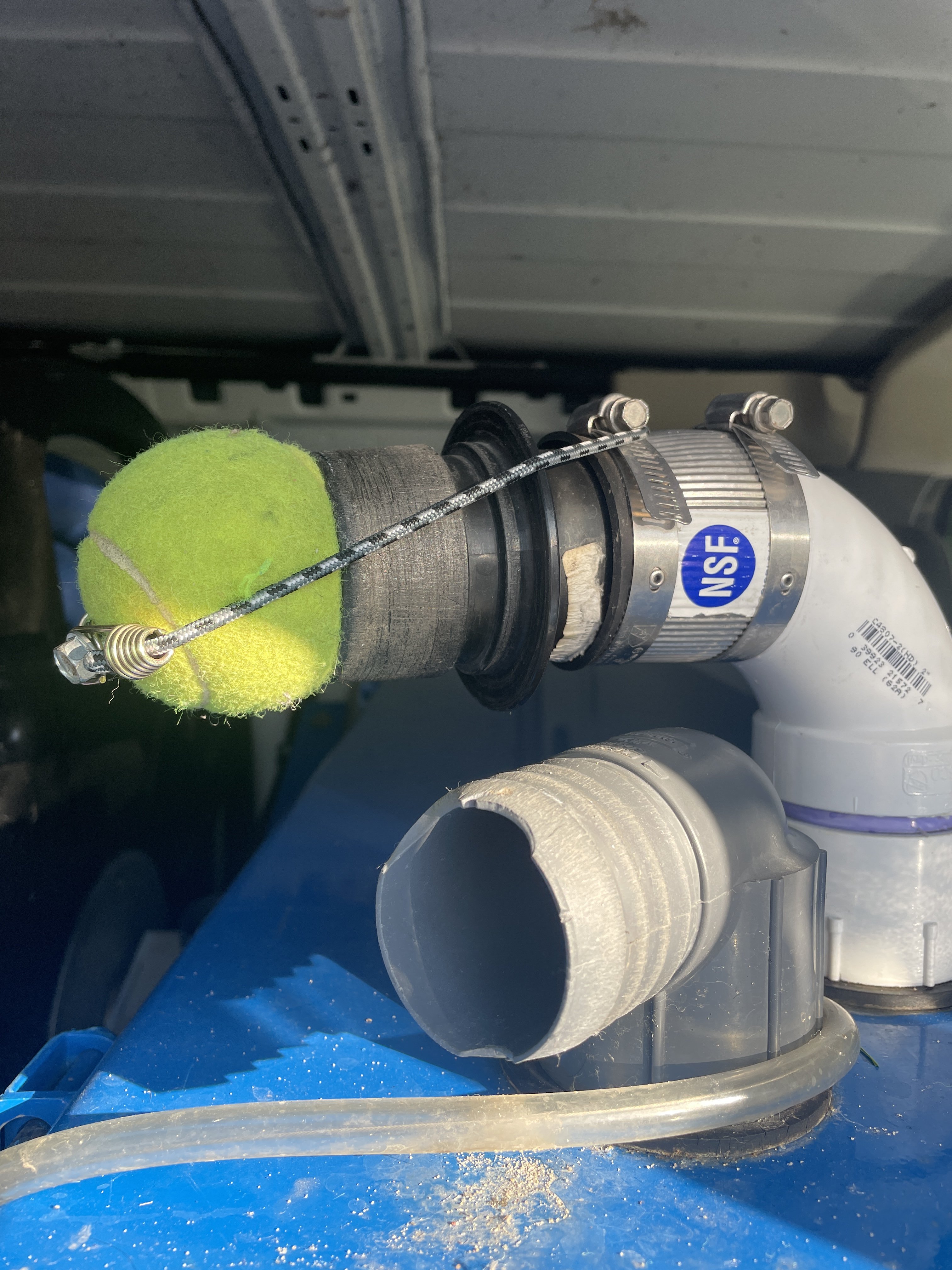

Loving this option after a couple days. First time I restarted remotely I had no suction. the tennis ball fell out of port 2 when machine off. Never liked the ports on this machine and had to customize from the start. My old Thermalwave has nice ports welded on and have rubber cap that I don't need to play around with. On this machine, not the case. I will find one soon, but for the last 6 years just been plugging with a piece of wood or a tennis ball.
Here is the quick fix. Now im set, and looks so high tech lol
