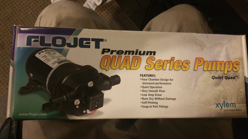

I have this one sitting here, I have installed it on HM truckmounts. It doesn't work for prochem because of the bladder tank.. Name your price, if it doesn't work for you send it back.

They should work great! They just don't do well with bladder tanks..
