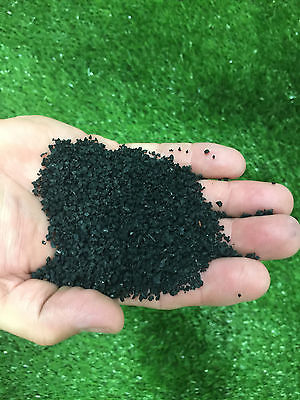

The kind they use on sports fields? We tested cleaned some and it does an amazing job of cleaning but those rubber pellets are clogging the filter too far to be productive.

Researched that a few years ago when I saw an opportunity. They make a special machine that collects the rubber balls and I believe if my memory is correct they apply some sort of microban type cleaner?

Yeah they pack it full of rubber.
The Black Part. The artificial turf's base material, or infill, is composed of granules of soft plastic pellets, sand, silica sand, crumb rubber or a combination of those materials. The crumb rubber is usually composed of recycled tires, and that is what makes up the black material in some artificial turf.Apr 12, 2017

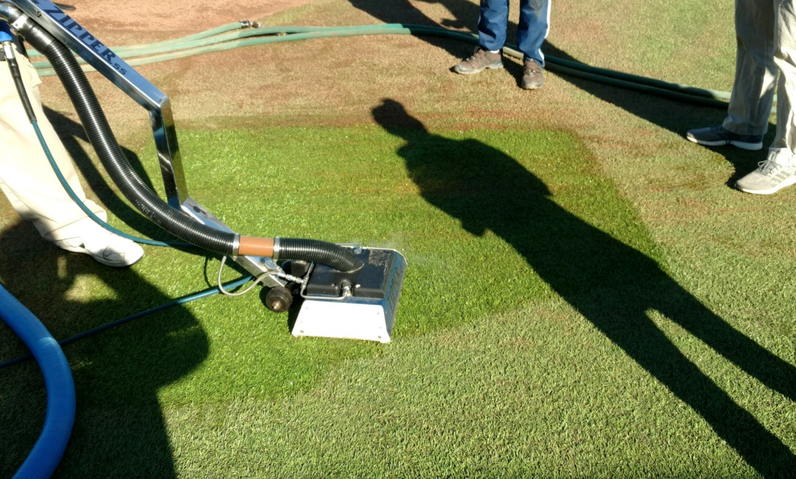

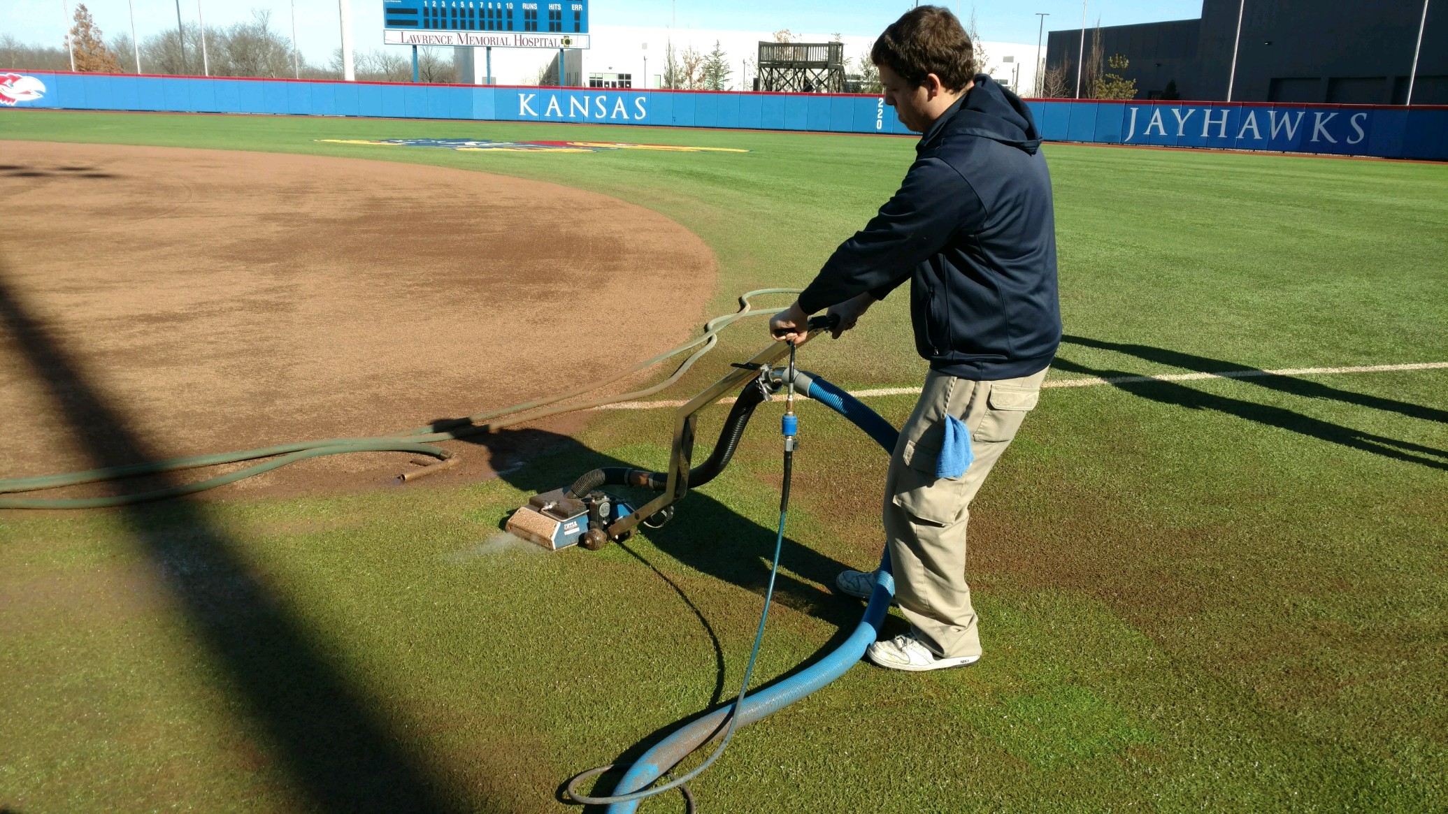

Dan wanted to try a Cimex on it. I thought he was crazy. :biggrin:
Not sure really. I wanted to try the ZIPPER first. Then they got so excited seeing it come back to green the wanted it all done.
We are guessing 2 Spinners (2) eight hour days. Not counting any messing with the pellets.
