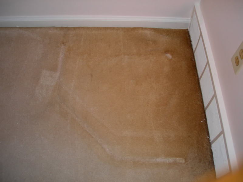

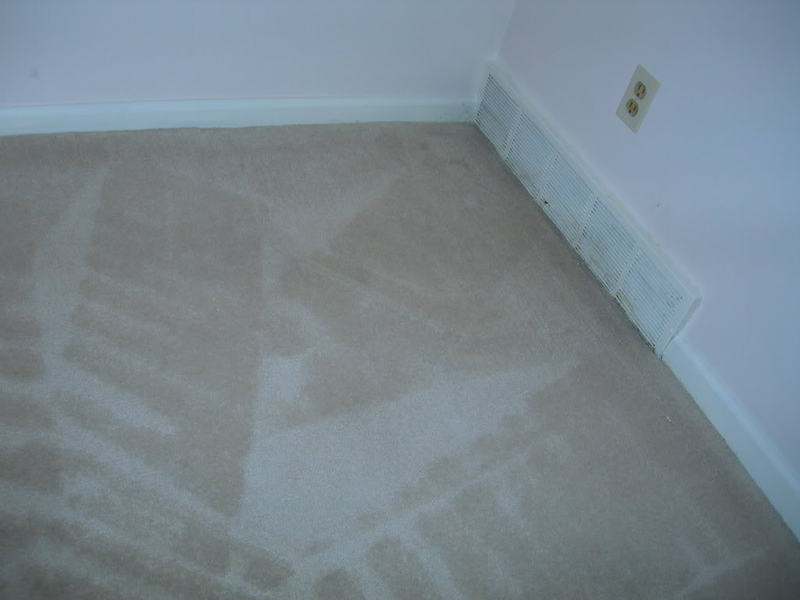

campusman1 said:
this house was full of nicotine for ten years never been cleaned i used the judson juice 02 pre spray and extraction dont have the bottle in here but les knows who i am i called him for the formula 25 oz of 02 pre spray and 5 big table spoons of hot sauce les remembers here is the worst picture.
