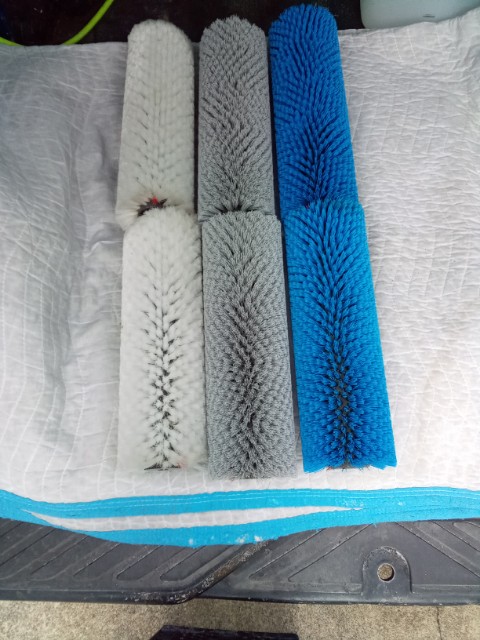

When using a CRB you must have the right brushes for the carpet
Brushes for 14'' Brush Master Pro 35 CRB
White is very soft and used for nylon
Grey is soft and used for abused nylon and polyester
Blue is medium standard brush that comes with CRB and used for abused polyester
A CRB with the right brushes is a must have for Residential Carpet Cleaning !!!
