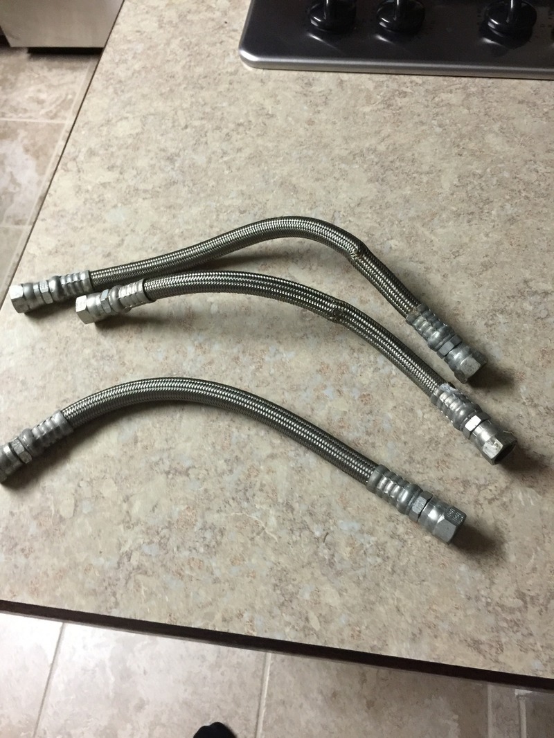

Are these cheap hoses?
or did they freeze?
I took a magnet to the fitting and it stuck to the magnet.
I don't know what freeze damage looks like on a braided high pressure hose.
Machine is only a year and a half old with 97 hours on it. I will say it was operated by a young person who had no idea what they was doing.
Probably going to have Larry make me some out of good year and see how long it lasts.

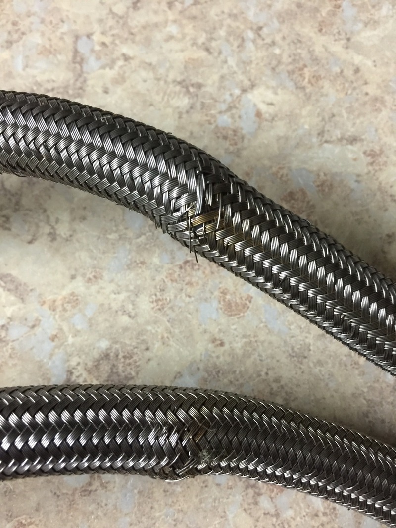

Definitely looks like burst from inside out, as i look at it longer.
Just dont understand why the crimps are steel, this is why I thought they were cheap.

While the braided hose looks like a great hose on first appearance, there is just plastic tubing inside. Not too much better than any other hose.
