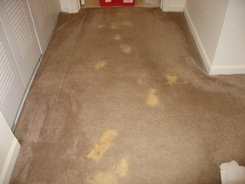

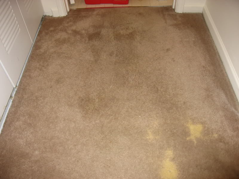

If not, why? It is fun, easy, and profitable. I did this yesterday. The customer is a 91 year old man who had an accident in his apartment. He tried to clean it with bleach. They want to charge him for replacement (for obvious reasons) and he is fretting about the money. I am not charging him full price for this, and should be able to save him from having to replace it. The after pic IS darker in the dyed areas because it is still wet, and I know it is not PERFECT. This one is so bad we are just looking to make the manager happy enough so she won't charge him.. I feel sorry for the guy and keep thinking how I would want someone to handle it if it were my parents or other family.
Before
After
There are probably about 40 spots like this. I just dyed a few to see if it will satisfy the aparment manager. I enjoy this more than cleaning!

those pics look photoshopped...an old man with 40 spots? that big? who can urinate that much?
I disagree with you there.
They don't look photoshopped to me, you can see the differences of pile laying in different directions with lighter and darker shades.
Also, the Urine didn't cause the colour loss, the bleach did. Of course the bleach mark will be bigger than the urine mark.
