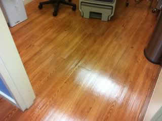

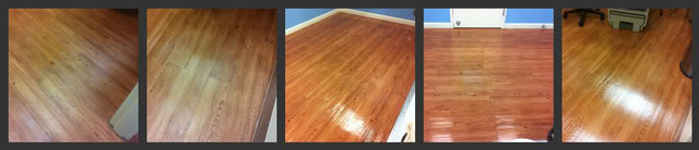

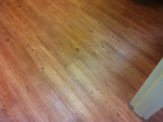

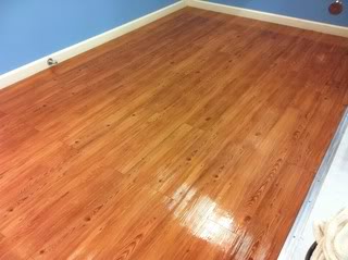

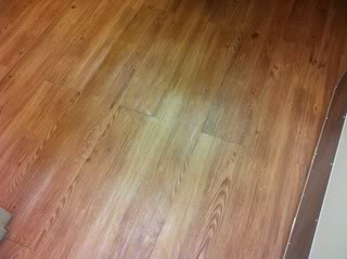

Ok, demo job is complete. Went to this newer location and to be honest the floor was not in bad shape at all. However, they wanted a glossy finish. So I cleaned with squeeky clean X 2 to get off all reside. Buffed with a white pad on the second app of squeeky and got some wax/white residue up which I followed by buffing up with Glad Pads (Thanks John G.) However, even though they looked much better at this point they were originally a satin finish so no way to make that shine. So I buffed again with red pad, rinsed with damp clean mop and put wax on as they requested. Outcome was just what they wanted, now we'll wait and see how it holds up. If we get 6 months out of it that will be ok since they are going to have it done every 6 months.
Can't wait till the next one or the one I looked at originally cuz we can make a much bigger before and after with it. And I believe the clean and polish just might suffice for it.
Thanks to everyone for their help and advise and very useful tips. In the end they wanted wax so the monkey is on their back.
