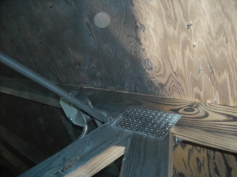

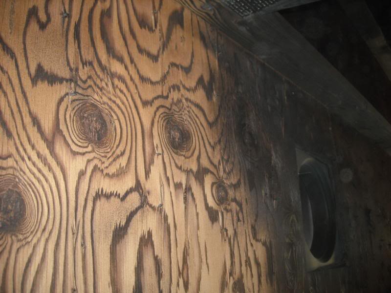

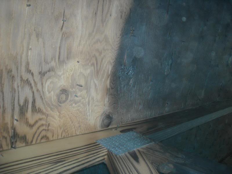

These are pictures from a fire loss where we soda blasted vs the old chem sponge and seal.
The homeowner was there one of the days we were blasting and was blown away by the results. The baking soda also reduced the odor as it removed the soot.
I think we had 22-hours of operation, went through 33-bags of soda and 34-gallons of diesel.
We will bill just over $5,000.00 plus materials.
Not only does it look better than sealing, but you don't have to worry about how long the sealers will last in an extreme environment.

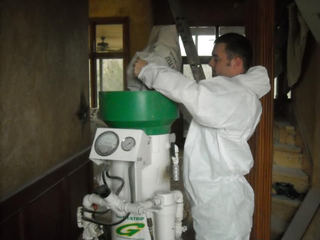

The unit we use is a Grand Northern around $7,000.00 for it plus we bought some extra hose lengths at the time.
You can rent the air compressor to run it, by the day or week, but after renting it for 3-jobs at ($1,500.00 a week) we bought a used one with low hours for $9,000.00.

It's a 280 cfm diesel, most rental yards have them for air driven tools, like a jackhammer.

Wayne Lawrence delivers it and gives you hands on instruction, included it the price of the unit.
Actually we use 1hp Vortex Axial fans to help exhaust (neg air) as much as possible.
Even with 2-axials you still can't see much more than the area you are working on.
It makes taking pictures of the actual process almost impossible.
