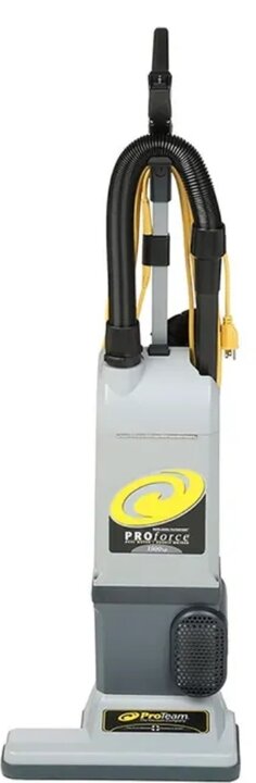

I can get a used new Proteam 1500xp 15" vacuum pretty cheap but I am concerned about the automatic height adjustment on area rugs. Anyone use these style vacuums on area rugs or is that style of vacuum best to avoid delicate fibers with?

I went through about 3 of those proteams before I said screw it. Too much plastic stuff that breaks, heavy weight, and a vacuum bag that's too expensive to be that small of a bag.
And if you're worrying about damaging fibers on a rug, the rug needs to be in a rug washing shop. Team up with a rug washing business and have them set up a pick up and drop off from your place
Or, if you are wanting to play with a few delicate rugs yourself and are messing with those rugs that might get damaged if vacuumed, get the dry dirt out another way by vacuuming the back of the rug upside down. YOu'll be surprised how much dirt vibrates down out of the rug just through vibration. Actually, it's the same concept of vacuuming normally from the beater bar, but instead of the suction of the vacuum removing the dirt, gravity is doing the removing.
But back to your original question, no, don't waste your money on that vacuum

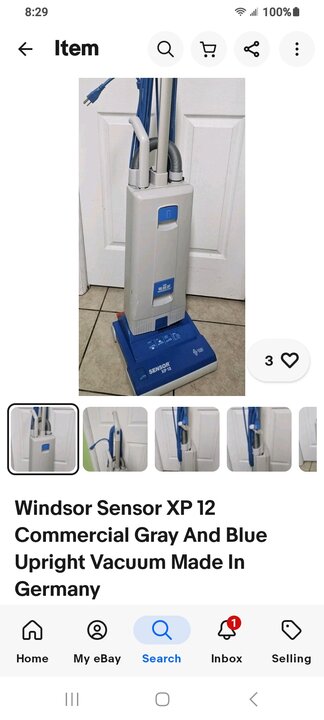

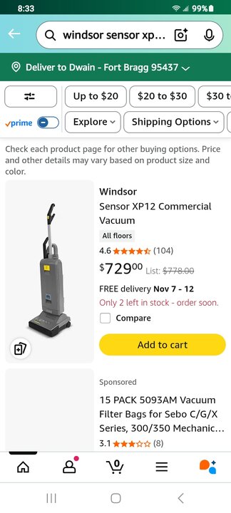

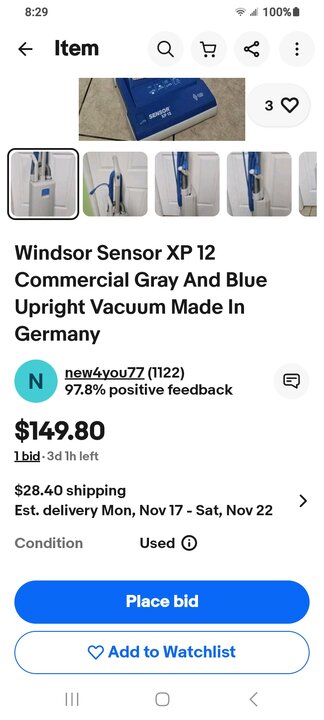

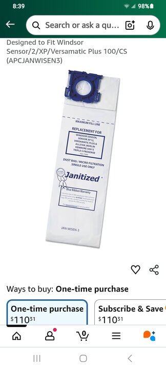

The windsor's xp12 like i have are around 700.00 new now they are very very well built. Bags run between .99 on the low end and 2.29 each for the best . I use janitized and buy by the case 1/2 off @ 1.10 each. If you look on ebay there's some great deals on used windsors. I've found that like a lot of commercial equipment its eighter totally worn out or like new Barely Used. I only bid on things like that if theres pictures of exact item im bidding on and have had really good luck. An added note: on this vacuum, the brush itself does not move rather a wheel raises and lowers to set the brush height based on the amp draw of the brush motor.
