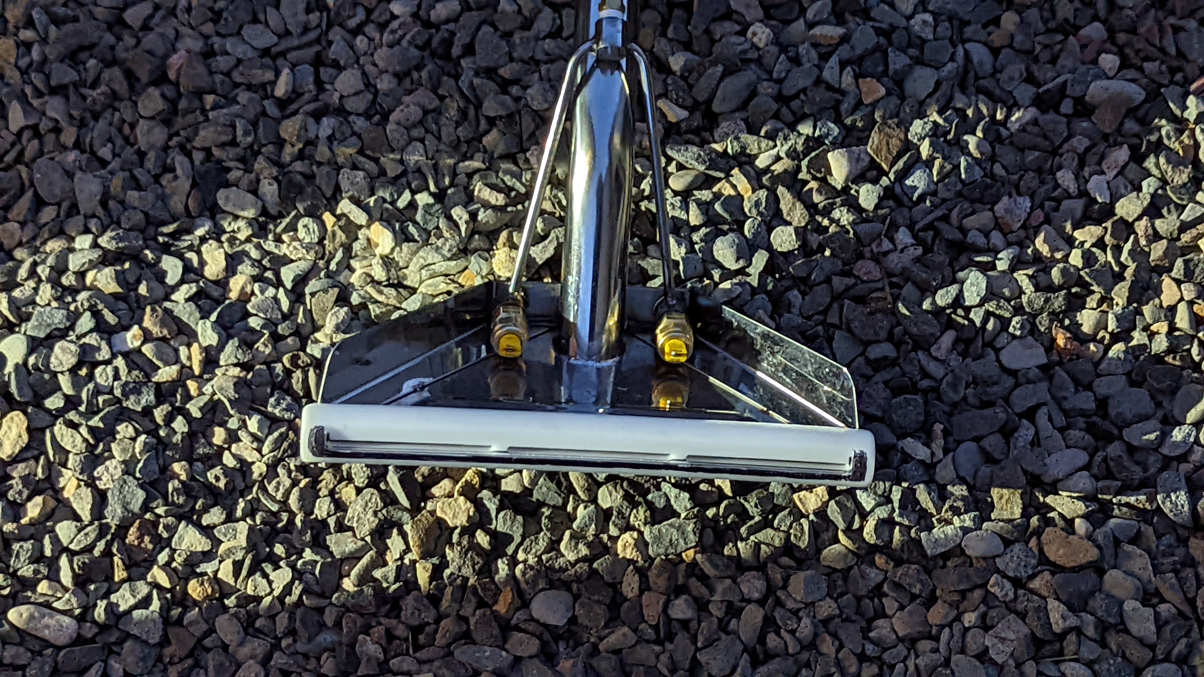

A huge step was accomplished in getting one step closer to a GreenBrushGlide for the infamous AW-29 wand.
Maneuvering the spray jets to sheer/strike right behind the Glide was a big accomplishment.
In this process I have an adaptor kit which would be PERFECT for a person who DOES NOT use a carpet Glide on this wand.
If you clean with this wand every day, on every job and have a critical eye for detail and think your cleaning process would benefit from having the jets strike much closer to the vacuum slot, please chime in, as I'm looking for a BETA tester.
I use my aw29's almost daily. Both are glided and an talking to my next door fabricator about cutting my supply lines and installing a sheer kit so that the cleaning solution hits at an aprox 45 degree angle. If you've already done this, I will gladly test it for you
117,240
Ive got a one beta kit to be used with Glides, and two kits that should work without a glide, for now...
28,265
My idea for a sheer kit was just to cut the supply lines, install flare nuts with 1/4 inch npt fittings, 45 degree elbows and t jets. My fabricator wants to weld stainless fittings that the elbows and jets can be mounted on. Either way, should be adjustable to hit just in front of the glide.
