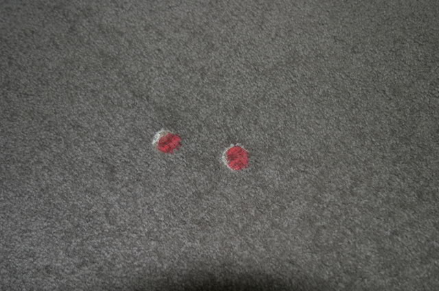

Cut pile carpet. 4 yrs with a fair bit of fade and wear.
Plug came out of the bottom of the bar stool and cut out two neat little circles.

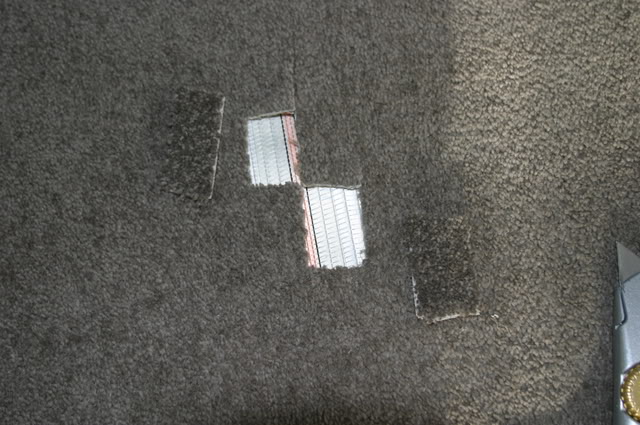

Only donor carpets was an off cut un touched from the attic. No fade or wear at all.
Full replacement cover from her insurer but decided to let me have a shot at saving it for him. First job for this office as they are 3/4 hour away.
Problem area.
Ready to go.

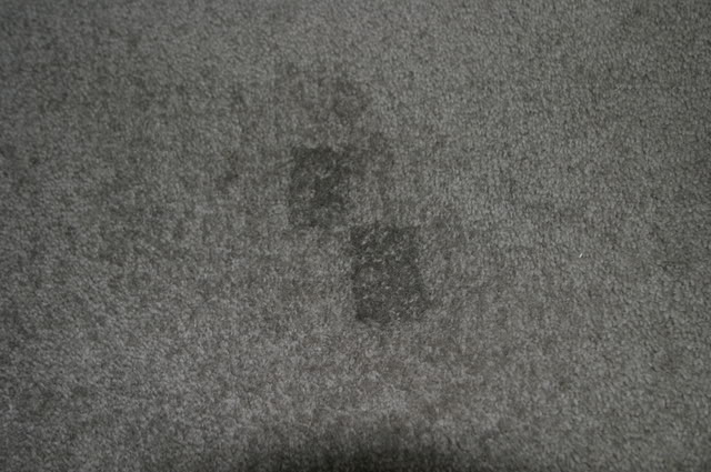

Glue gun seamed the edges, KG tape underneath. Ready to 'fade' it to match.

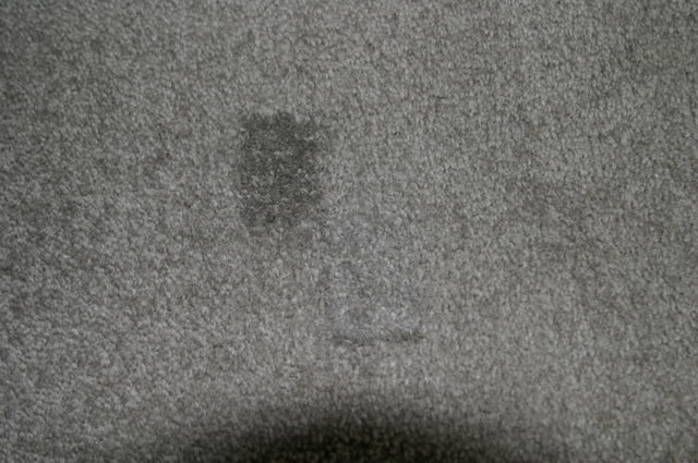

Half done.

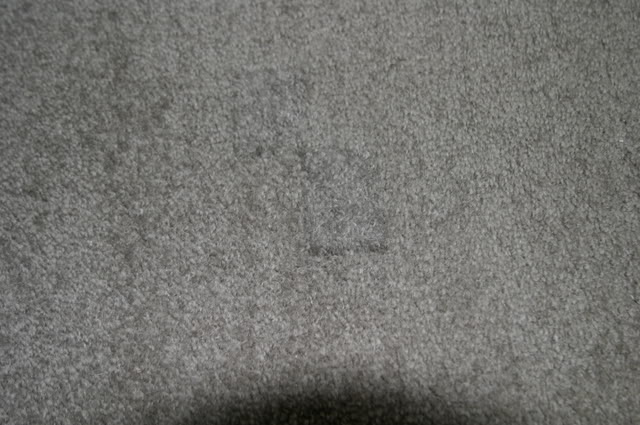

All done. You have to really look closely to find it.

My first time with a crayon, no longer a virgin :lol:
Not perfect, but I got $270 for about 1.25 hours.
Not bad aye!!

I should clarify that last statement about being hard to see.
If you walk into the room, you don't notice it and you have to really look to find the repair.
If you know where to look already, then they are noticable, but only for a month or so because of it's location is a traffic lane on the edge ot the curved breakfast bar.
This is on the main traffic lane from the fron door around into the kitchen and onto the family room so it'll wear in fairly quickly I'm picking.

nice, did you freehand cut the pieces, use a template, straight edge, or how did you measure the cuts for the donor pieces?

I free hand all my repairs.
The carpet is actually sitting up in the middle giving it a non square look.

Hot Dang !! John took you a while but looks great and we look forward to more of this in future.
Did you try anything to imitate the wear - like a pumice stone ?

Tony, I tried to rough it up on the pebble stone path, that didn't do much so I then tried it on the rough brick face of the house and that did it a bit better.
I'll have to try pumice stone.

Great work there John, thanks for the crayon demo :shock: what color pen did you use.

I'd have used some white and a couple of different grays ( greys ).
John, on the bottom of the right hand square where there is still a line of darker color, here's what you can try the next time. Take a small flat spatula or half of a bull-dog clip and bend the row of fibers (fibres) over to expose the sides and then add the white. Then do it again from the opposite side. You will be amazed how much of the white "telegraphs" to the affect the surface colour. This has the added benefit of not changing the hand of the wool.

Craig, I only used white.
I did pull out a grey but it was way too dark and it was the only one.
I bought a small 10 pack.
Thanks for the suggestion Tony, I think I need to get a better selection of crayons to do it better justice next time.
Incidentally, I didn't notice the darker line while onsite, it only really showed up via flash photography.

I would think he did that intentionally to put the seam tape under without damaging the edges.

Steven, Harry nailed it.
I often do a small cut beyond the repair area to get tape under and then often run a small bead of hot melt glue in the cut before fitting the insert.
By doing this, it saves stretching the shape of the cutout while getting the tape under.

Stephen but whith the hack repair it was still not together. It was gapped. Looked like crap.
