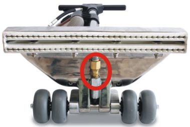

I am not a big fan of the check valves in the jets.
They distort the jet flow.
A better innovation is on the Mytee Ti swivel wand & Bentley Pro,
where they have put a check valve at the bottom of the solution line to the manifold.
My check valves in my jets are wore out. Could I put that single check valve on my mach15? If so, could you send me a couple of them?
