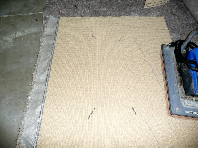

http://www.wisegeek.com/what-is-berber-carpet.htm Berber is just like what people refer to as sisal. It is truly misrepresented.
John Let me explain this . Not all times it is good to separate the secondary backing. In doing so it does make it weaker. That is the reason for your dipping. Think of it like this as your tearing or separating the latex is falling out making it weaker. If it were not for latex , Carpet would be as pliable as a sweater. Nice patch though. Also get a glue gun that is 100 watts. I don't know what that would be metric.

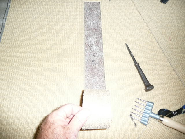

John another question . When I do a patch as you did. I will glue only the primary backing and secondary backing . You don't need to glue under it . By gluing only the primary and secondary backing it is strong enough to hold. Try it on a sample do as I say glue it and than tear it apart.

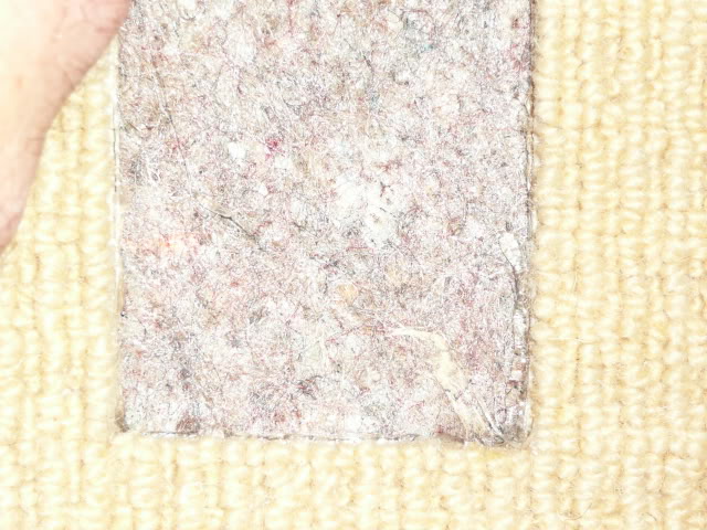

Harry, I was only gluing the two backings together. I didn't glue though the primary, although I imagine that a fair bit of the glue would have penetrated through to the underlay (pad) anyway.
As I was putting it in, I felt that the donor was sitting above the existing because of a lack of wear. I hadn't noticed the dip on site, I only noticed it when I down loaded the photos to the computer.

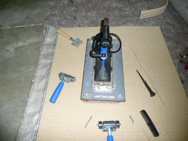

thanks, I went back and now I understand what Steve was saying about heating up the edges for a better fit. Awesome job.

john try a sample of not grafting these goods. Apply your application As i spoke of . When taking the secondary off it is for , Just like Steve said manipulation . If the pattern matches fine . no problem see for your self. The best way to learn for anyone is trial and error . I have been installing for 25 years. I am still learning .

Let me understand this what irregularities are you making consistent . What was Steve Talking about .I think we need Steve to clarify the judgment. You are not melting any synthetic plastic edges. Godfrey Hirst is a jute backed product and jute back product only. Now I am confused. These products do not peel off the secondary and make it weaker than it already is. Why the latex is a better quality latex. This is a area where We master at . We are here to educate and when I educate it is specific. . Godfrey Hirst is a flat weave wool product with an attached jute backing. I hate to confront .

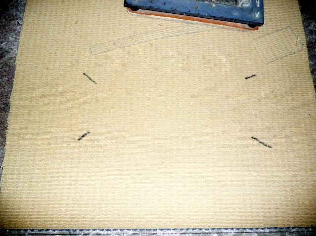

It ok Harry, I'm still learning, so I may have done it incorrectly???

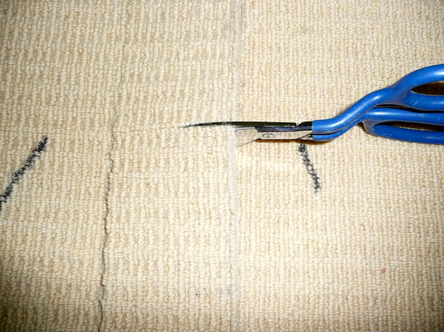

I removed the jute secondary backing and if you look at the second picture above, you will see 'lumps' of the jute fibres still caught in 'lumps' of latex. I was evening them out, so that it would sit down nice and tight.
Are you suggesting that by doing so, I've weakened the donor to the point I've compromised the whole repiar?
In this case, would you have left the secondary backing intact?
John

I am now running a row using a
comb.

After running the row. I use my top cutter with blades on the inside. I don't want to much of a guage on this material.

I did reply I don't know what happened. I sealed it as you would a commercial glue down. Along the primary and secondary.

You are a layer, and install carpet to stay down, I come from a predominately restorer background where carpets need to be able to come up and be re installed.
As such, if you are using the cushion/pad as a backing/bonding material to support the bond, do you have a problem with it being a shorter term fix or am I barking up a tree on this?
It's just that I have had to fix numerous 'repairs' in cases where we've had to lift the carpet from a damage situation.
That's probably the primary reason why I always use a backing tape etc so that the carpet is still lift able/stretchable etc without it being bonded to the cushion/pad.
Also, and I realise this is different, but one of the local retailers' subbies fixed small problems in his install with latex. He cuts out the offending row/tufts or whatever, trims a small insert and then pumps the area below with latex and sits the new piece in. I've 'repaired' a dozen or more of his 'repairs'.
Again, I may be making a mountain out of a mole hill simply because of my back ground in water damage restoration.

John I was just showing that with the same product very much in similarity . By not distorting the backing , Or manipulating it in ant way . There is flat smooth surface. That repair as I claimed you can stretch off of that. John the most important part of putting a patch in is sealing it ,correct. I guarantee that is there for the longevity. I made that repair around 2 inches. I was showing a method. I would have prefer ed in that case to use the Kool glide. :D
