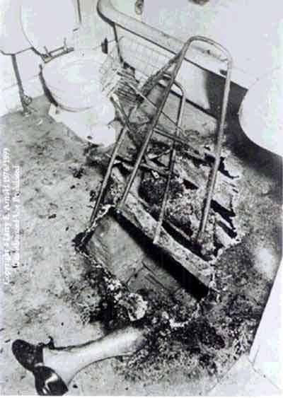

There was another case caused from an overweight woman wearing panty hose.
She was walking briskly on her way to the restroom across a large office.
The static and voltage was so great that she spontaneously combusted.
Witnesses said they thought they smelled something burning and then saw smoke coming out from under her skirt.
Then in a blinding flash of light all that was left was just a pile of ashes and a pair of smoking stiletto shoes.
Sad story. But, great shoes!!
