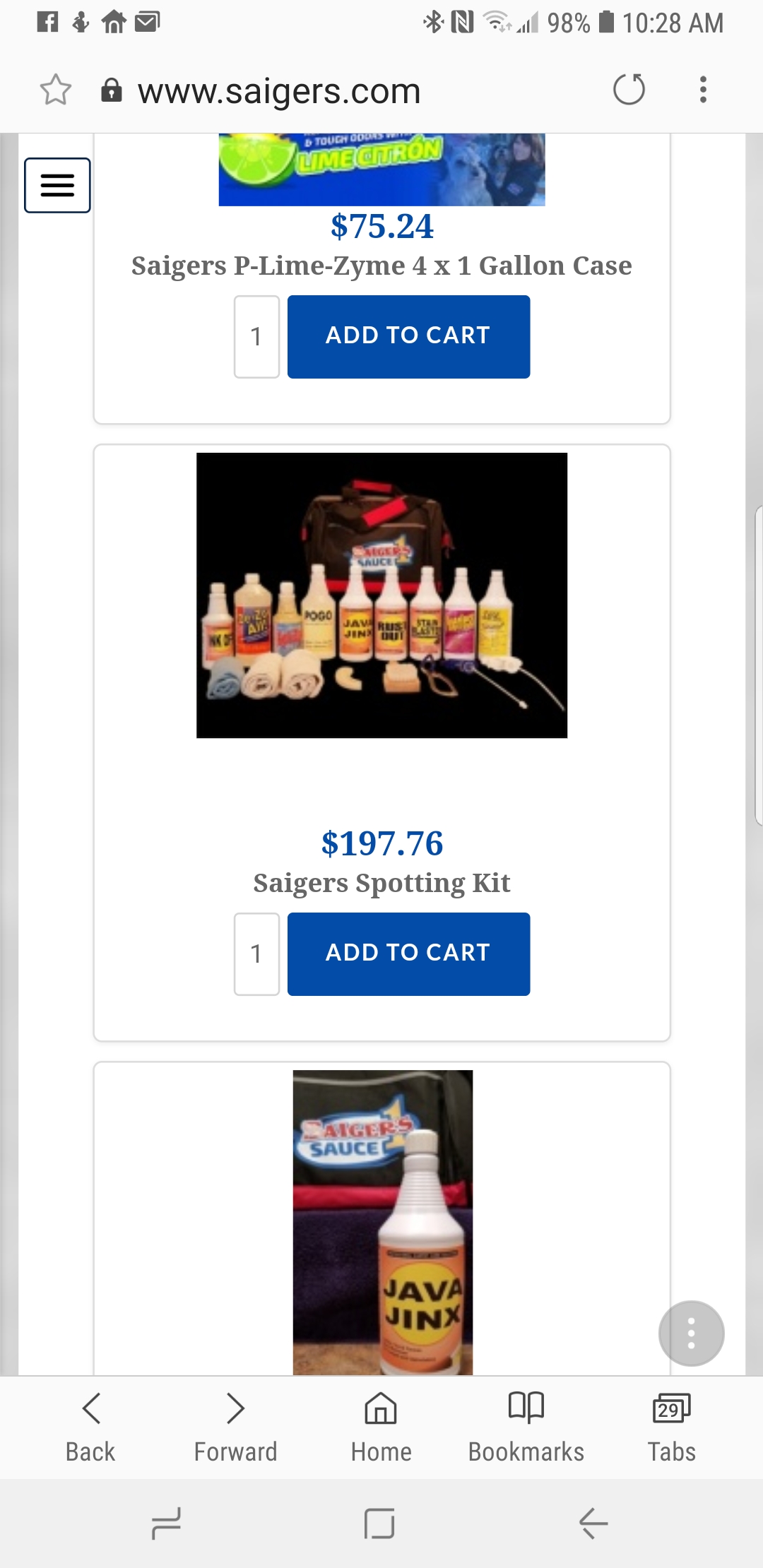

We have everything in a spotting bag. They are available at our webstore or JonDon
