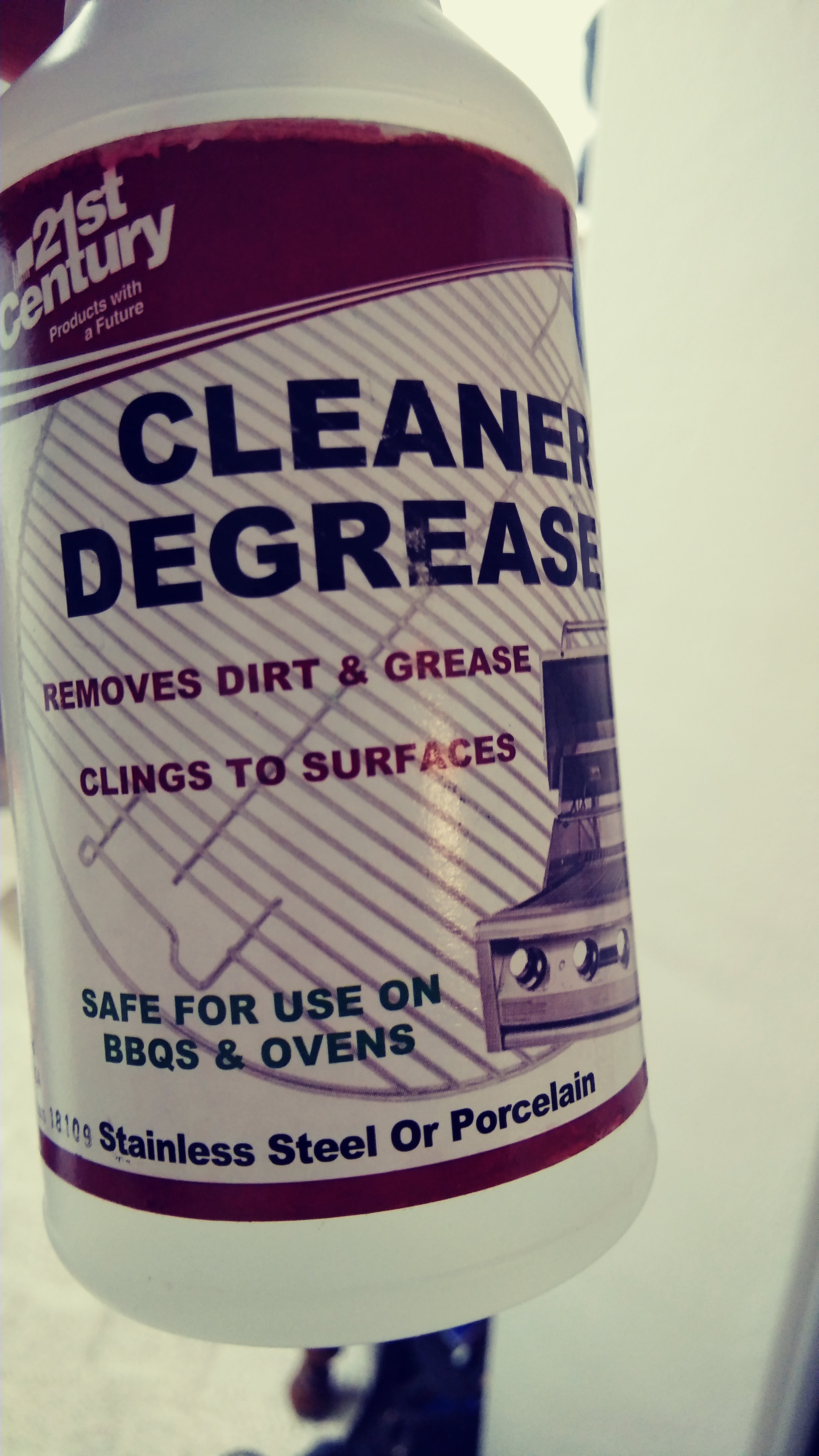

13,372
Haven't tried this on carpet yet not sure what's in it but its a new favorite cleaner on rental flips. No odor or very light no gagging like purple power. Only need very little. Really foamy though.
