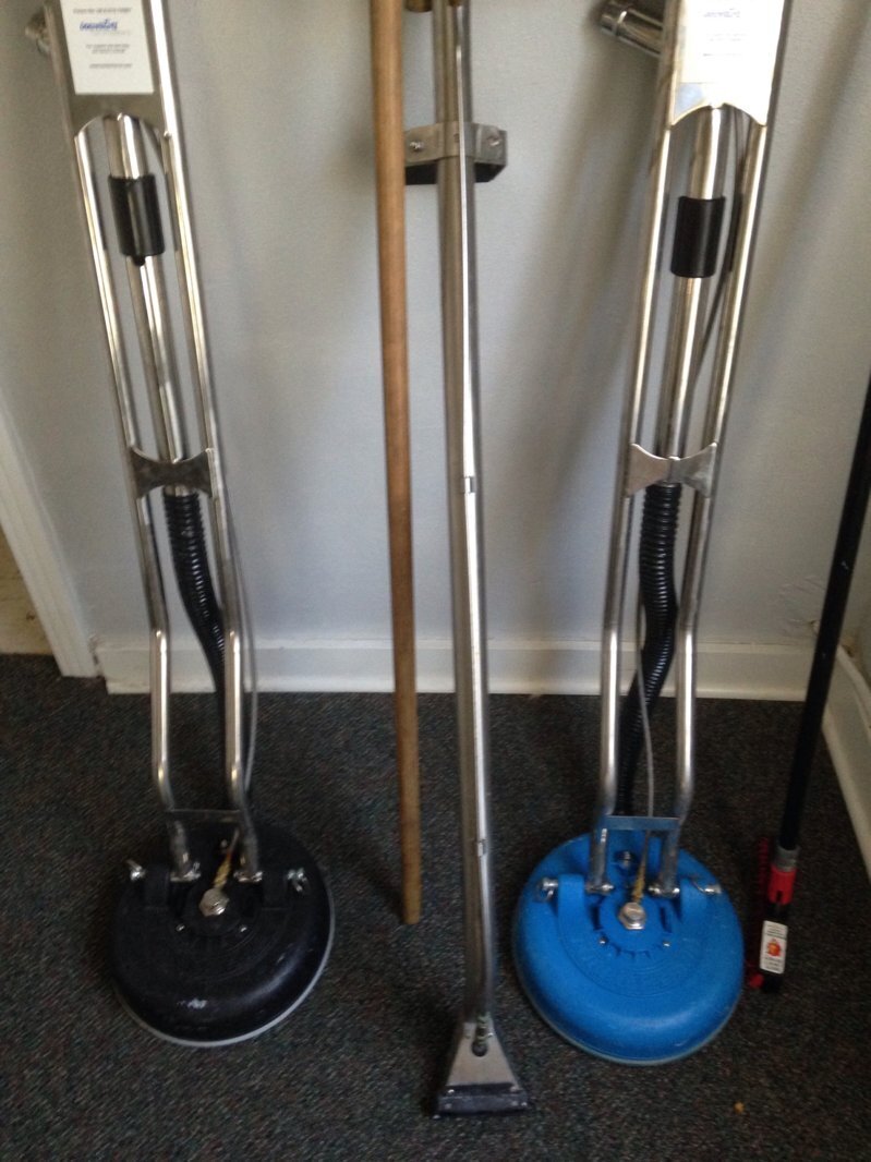

I've got the new gekko that Scott posted and it is definitely better than the original gekko. I didn't care for the original one so I sold it. The new one has a assist handle and feels better holding it.
117,324

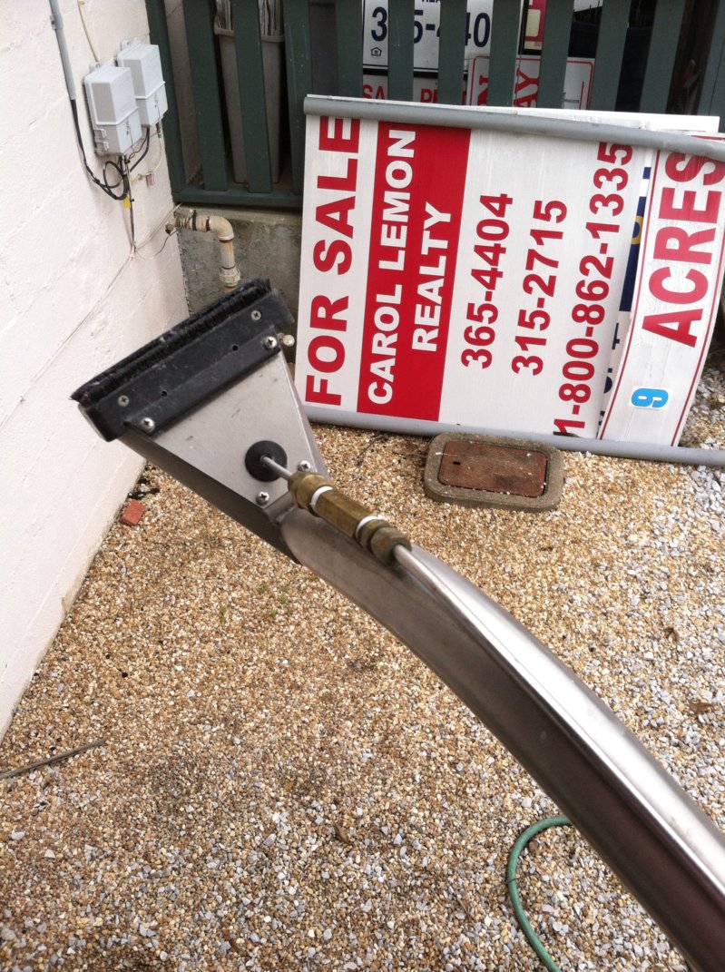

I have the hand tool version of Marty's edge wand from PMF.
Great for walls, counters, tight spots etc..
Actually we have three of them now..
realclean
Sep 4, 2012
429
Jesse Lowe
I like the small wand Marty has in the photo, get for corners, getting right next to baseboards where the spinner does not, and behind toilets.
I also like to stand up!
T
Total_Rookie
I've also got the hand tool version of it as well, but seldom use it anymore. Standing up is wonderful.
Marty, Does it get real close to the baseboards? That has always been the hardest part of cleaning tile for me. That darn lil 1/4 inch!
Just throw a wet cotton rag or towels o the floor and Nike shuffle anything that still might be on the floor in the corner.
I used the previous gecko model with the corner attachment and it was a nightmare to use. So now we just turbo tilt and towel dry the baseboards when done.
