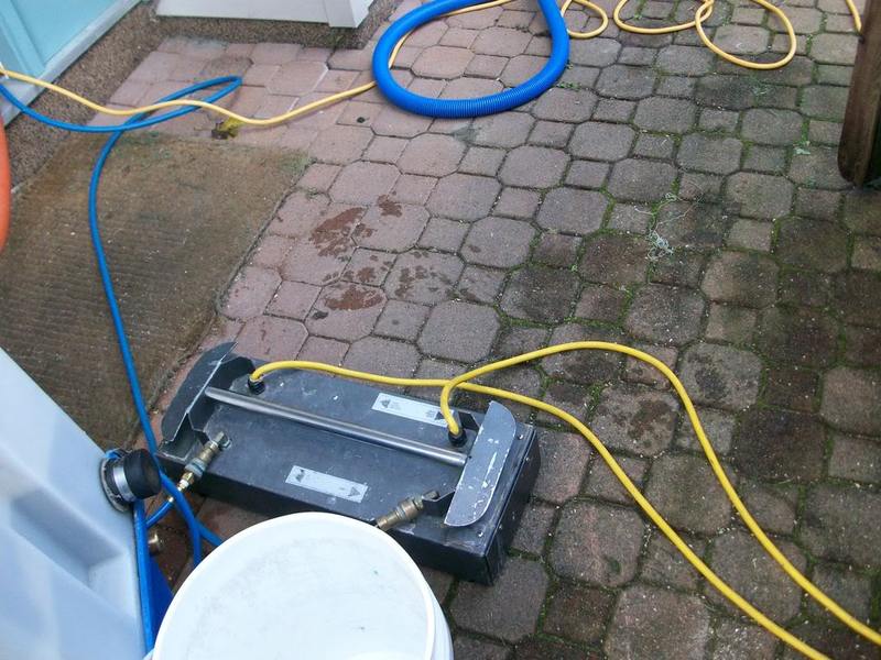

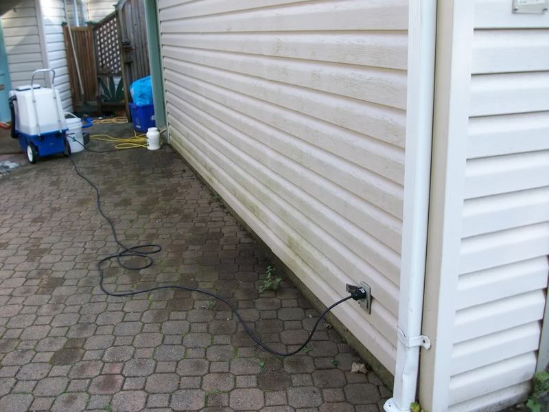

Here's a 7 cord set up. Only 3 for machine and 4 for heat. I've done it a few times and always live in mortal fear of a power surge.
2 plugs for base unit- 3 vacs, 600 PSI Pumptec.
1 plug for vac booster
First 3200 watt heater
Second 3200 watt heater. The water gets screaming hot on one, two really doesn't make any difference unless the wand is keyed for long periods of time.
No blown electrical, but I ran 3 cords into the shop. This was a buddy's house and I just was playing to see how much I could squeak out. I've also done this setup in an office as well.

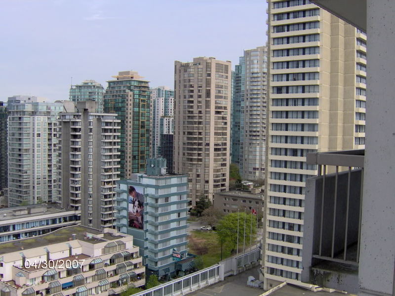

I had one and maybe the learning curve was beyond me or I didn't feel like I was getting the carpet as clean as I liked or in a method I was accustomed to. For the most part, I run 4 cords with ease, 2 for machine, 2 for heater. Here's a peek at the downtown core, millions of sf of carpet in a 20 mile radius and most guys trying to service it with a 100 psi Ninja. :roll: One place I've worked in had the top 2 floors of a condo(28 and 29) converted into one suite. It's sort of a boutique market, but it can be profitable and I also service ground level :wink:
I took this pic on the 12th floor:
This is about a quarter of the high rise area

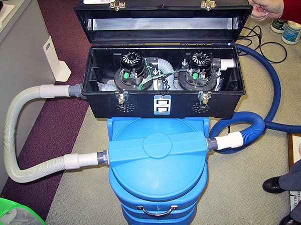

And here's the quad vac setup I had on my old Ninja, with a big azz old General pump, pegged out at 500 psi. It was a 3 cord setup, but AWESOME power:
