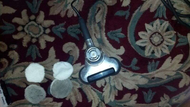

Get a few orbital car polishers & some velcro. Glue the velcro to the car polishers and you have a mini op machine/knock off Stepson. Or you can subcontract it out...

Got a stepson. Doesn't seem like it will work as good as the angle grinder though..maybe I'm wrong but I just feel like the results would be as good..I will try a few 1/2 and 1/2 to see..
