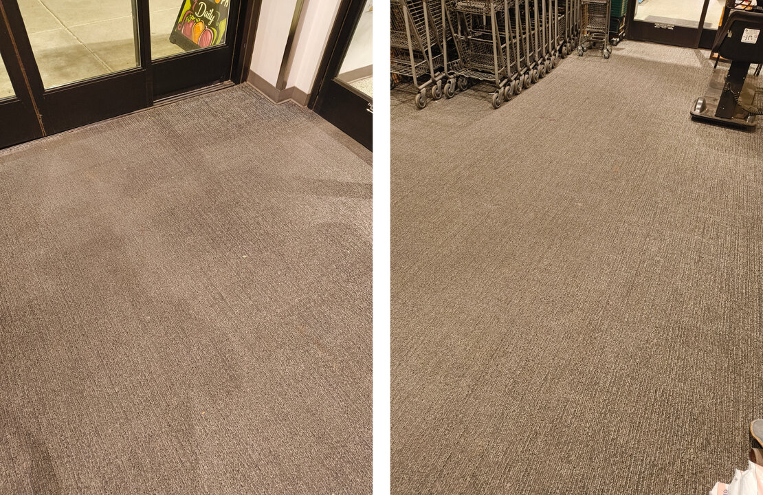

Hi guys,
What's the best approach for getting best result for dealing w/the traffic lane on this kind of track-mat entry-way carpet?
before:
I think the issue maybe is with the agitation method I've been using.
I pre-vac, spray heavy, scrub with red pad and extract on my highest TM setting.
Is there something better than red pad for this?
This regular customer is a busy store on a busy street and their entry gets trashed. They are always complimentary and overall seem happy and I think it comes out pretty good ... but deep down I know I can do better on that traffic lane.

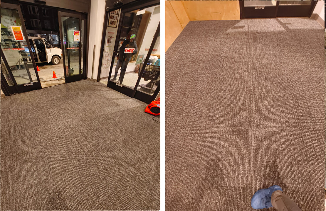

after:
While we are at it, what's this stuff called officially? Track-mat?

You could do a green pad if it's really trashed. It want hurt since you "prespray heavy. Especially on carpet tile.You might want to run it on cement wet a little, but not a lot.

I tried green once and it tripped the fuse on my 175. But maybe with more lube it could work. Maybe worth a second try I mean.
Reactions: Kenny Hayes
14,632
500. Too low you think?
Too low
When I cleaned those types of entrances, I went up to 900. There’s layers of parking lot crap that needs more aggressive pressure.
You won’t hurt it. It’s plastic carpet with rubber backing glued to a concrete slab

Thanks! I'm going to crank that next time.. I wasn't thinking about it that way.

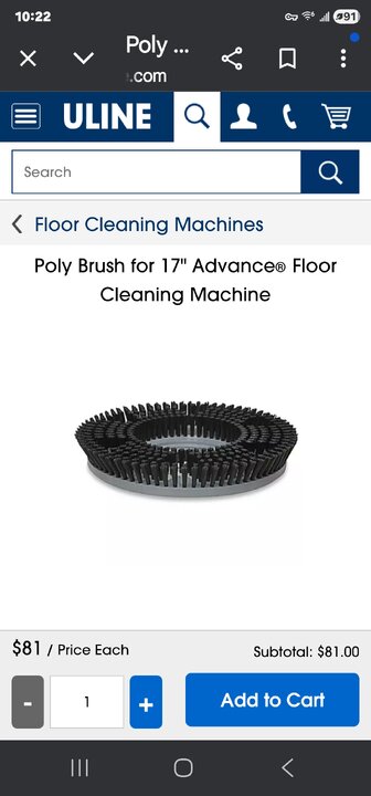

For something like that I like this type of brush on a 175. I use a tank for the cleaning solution so I can add it as I go using more where needed and save a step.
Save the odorcide for residential.

But that brush comes in handy. I like it better than pads for jobs like that. It doesnt hold the sand and debris cutting fibers like pads or bonnets can do. Digs deeper too making the job easier to rinse.

This is the answer. At least my next stop in this place. It's what I'm trying.
I have a brush like this. Never used it because I wasn't sure if it is mainly a stripping tool and I've been scared it would shred a carpet.
But this mat is made tough and digging deep is whats needed I think.
This brush and a higher PSI is my strategy next time I'm in there.

If you haven't used the brush yet run on it on concrete for a few minutes first to break it in.
