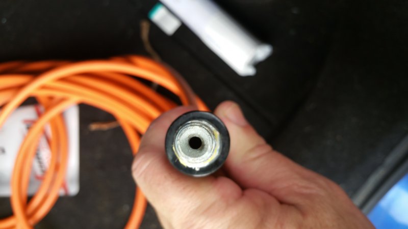

This solution hose caused me a full day of frustration. If you'll notice the hole in the parker fitting is very small.
I wasn't getting the right amount of water volume to my upholstery tool or 6 jet wand. I of course blamed different components of my TM and tools at first-- after all, why would I blame a brand new hose with brand new QCs..
On the last job I decided not to use this new hose and the problem was almost solved.. I blamed the problem on the new QCs because they were probably Chinese knock off-- so I installed these QC "knock off" on another hose to test to if it was the male or female giving me the problem--- both worked fine..
So it had to be the hose! WHY would a new hose be a problem!? Then I compared the Parker Swedges on the problem hose to a working hose... the hole in the problem hose was 1/2 the size of the working hose..
Hope this post saves someone a headache in the future.

Ofer.. I installed the same QCS that were on the problem orange hose onto my old blue hose which had larger holes in the parker fittings and the water volume problem was corrected. .
I really think the smaller holes are the problem...

I see it as this way--- a 1 1/2" vac hose moves less air then a 2" hose... I really think someone installed the wrong parker fittings.. the hole in the parker fittings of my blue hose that working fine is twice the size of the one in the picture....

are you sure they are parker crimps? You have to use parker crimps on parker hose and use a parker die. Otherwise you can "crush" the crimp or it wont crimp and blow off. If it is a parker crimp is it stamped 10156-4-4
