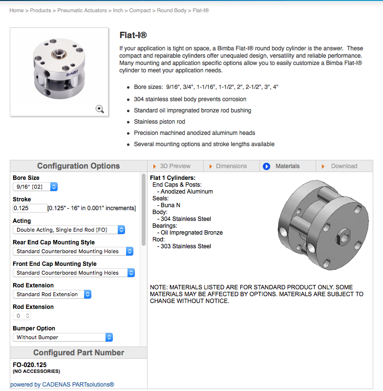

Are Sapphire units the only machines that use a Bimba?
Which actual device are we talking about? http://www.bimba.com/
At 164 hours mine has not gotten lippy with me yet but I want to be ready to smack it around..
Looks like this one to me http://www.bimba.com/Products-and-Cad/Actuators/Inch/Compact/Low-Profile/Flat-One/
