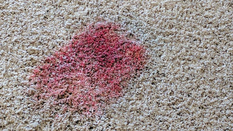

Speaking of transfer...
Slurpie dumped on a Persian rug..
What would it take, other than a knife, to remove that?
Chemspec RedXit did nothing
27,319
Slurpy probably needs an oxidizer rather than a reducer. I recently has a similar rug with Chinese food spilled, color bleed from cleaning efforts. Looked like a reducer all the way but did nothing. Using a 2 part oxidizer removed the Chinese food and lightened the bleed as well. Will try one more treatment and see how it goes.

Interesting that the Slurpee spill is rectangular. Most liquid spills would splash in all directions.
Assuming natural fiber since it was called Persian rug, I would go to Masterblend's Magic Color Remover. Pretty strong reducer. Works well at removing color bleed from natural dyes found in rugs. Be careful. There is potential to overuse and harm the rug.
