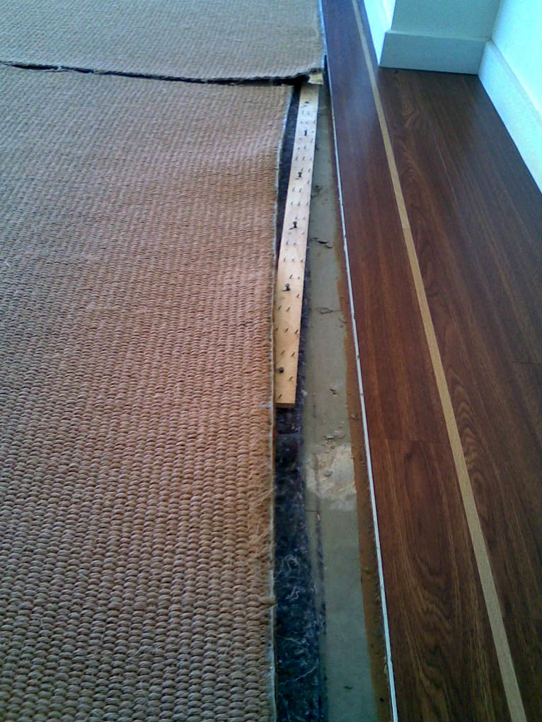

If he can show a picture there can be some options to what and what not to do. If it did shrink 3 inches sounds drastic. However I have seen it shrink 3 inches due to flood . Most likely it will shrink more in the lenght and you wont be able to puy a cross seam in. Post a picture please.

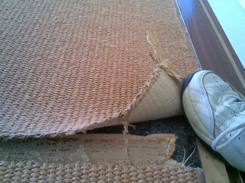

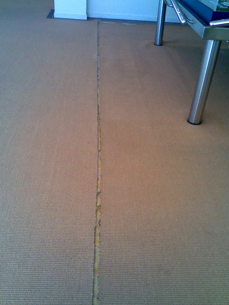

Here are the pictures.
As you can see the seam has been joined together conventionally with seam tape. The problem here is that the underside of the carpet has rubberised backing, hence the heat tape will not function correctly. As you said John, the sisal should have been stuck directly to the concrete.
I walked from this job but am trying to help the boss of the carpet cleaning company by getting as much detail as possible to prove that the installation was incorrect. Any further help on this matter would be greatly appreciated.

Here is the problem.Latex (coating) . Without this coating the sisal would be a birds nest. Now it should have been glued down. With a 1/8 x 3/16 X 1/18 inch trowel around or simular. This is where someone who does not know installation specs screws up. The reason the coating didnt hold. The natual fiber (Sisal) Shrunk enough to rip apart from its body.You could rub the coating off with your fingers. Anyway it should have been verified type of install prior. When I make area rugs with Sisal I do use seam tape. Or I make a cold seam with latex. That is a bad one It does need to be replaced . Find out the company that installed it to mis specification. Best way to clean that is Host or Encap .

Even if the specs DID allow for a stretch-in, it should have had architectural or double tackless strip.
Only time I've eve seen that kind of shrinkage on a wool carpet was when it was flooded.

IF this specification relates to the carpet in the above pics, it's been laid correctly (and I cannot say I agree with it, but let's stick to facts).
'No cross joins' can't see any.
'Heat bond tape to be used' evident
'Architectural smoothedge' also evident
'Jute or jute/hair combo underlay (padding for you guys)' a reconstituted fibre underlay has been used on this install, which has similar, if not superior property's to jute (alone) underlay.
So IF this sisal carpet (sic) is supplied with the installation specs below, the layer did the job correctly (and I'm having trouble saying that)

N.B. For the best possible results, we recommend that all natural fibre carpets are
installed using architectural smoothedge and put on a 7lb 100% Jute, Jute/Hair
combination commercial underfelt or Bridgestone Cushion Pad.
M
breezeman
Oct 29, 2008
26
Well, stated Micheal.
Did you see the force it had on pulling the tack strip off the the concrete, It looks more than just a prespray. I have wet cleand sisal before, but you have to be very careful and use a brown- out after cleaning.
Deron
timlakeman
Jul 24, 2008
19
Thanks guys for all your input. I posted this because I knew there would be a lot of opinions floating around (all valid). I personally would not touch the stuff, even when I was cleaning carpets I would walk from anything that even looked remotely like sisal. It proves that all carpet cleaners need to know about this and should be trained either to know what to look for (and walk) or to know correct cleaning methods.
I've only been in the trade for 3 yrs now and this is the second time I have come across this problem.
Thanks all!!
