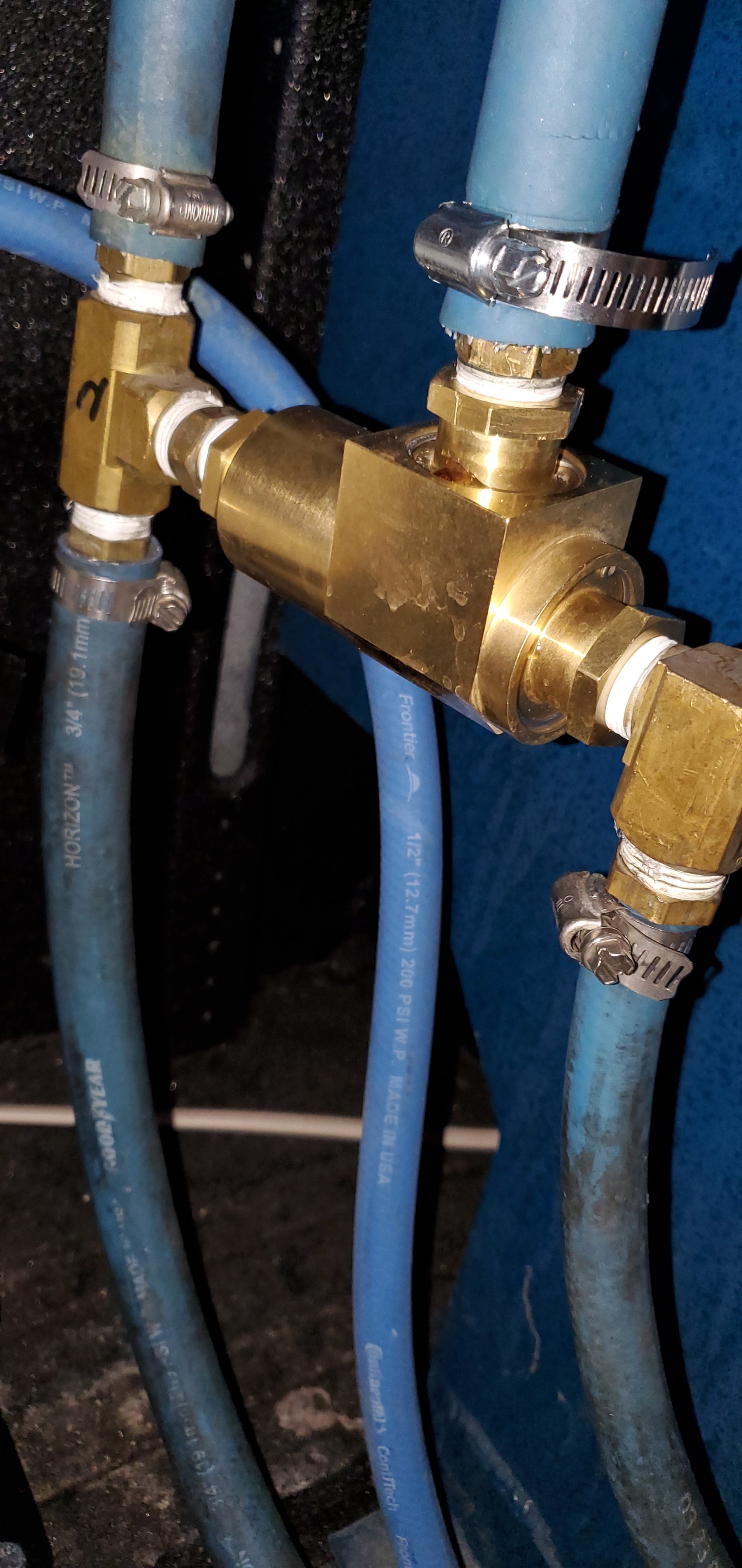

Currently, I suspect the Rostra-Vernatherm bypass valve under the waterbox... And also the possibility that the vacuum heater-core may be gummed up. But I also wonder about the engine's thermostat (which I have, but haven't changed) and temp sensor on the Kubota. I also wonder if it's the computer, or the electronic throttle control wigging out.

It seems after I dismantled and reassembled the Rostra-Vernatherm bypass valve that the machine functioned almost flawless for a couple days. The second day it started to drop to idle once; but quickly revved back. The following day, I tightened another connection, opened up the blower heat-exchange and simply used compressed air to try and blow some gunk out. This gave me nearly a full day without incident.

An UPDATE:
I replaced the thermal bypass valve over a week ago. I've been running the BlueWave at full heat, and it has not dropped to idle once, since replacing the valve. It seems like this was the culprit.
Basically, the valve was stuck, which caused the hot water to keep getting hotter, rather than mixing with the cool, fresh water entering the water box (water is recirculated, rather than dumped as waste). At a certain point, the Kubota's coolant is not loosing sufficient heat via the heat exchangers, so the kubota computer reduces the throttle to idle until it cools off sufficiently, at which point it revs back up to operating speed... at least this is my working theory.
