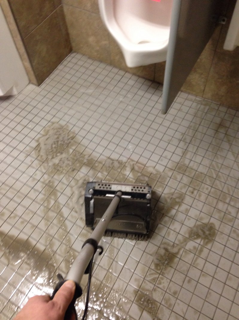

I do recall you posting about a demo you did at a restaurant with the DD. You posted a pic and looked amazing. This was at least a year - maybe two - ago so I could be funny on this. With that said, I'm sure a wand, or even a wet/dry vac, would be simpler and faster.

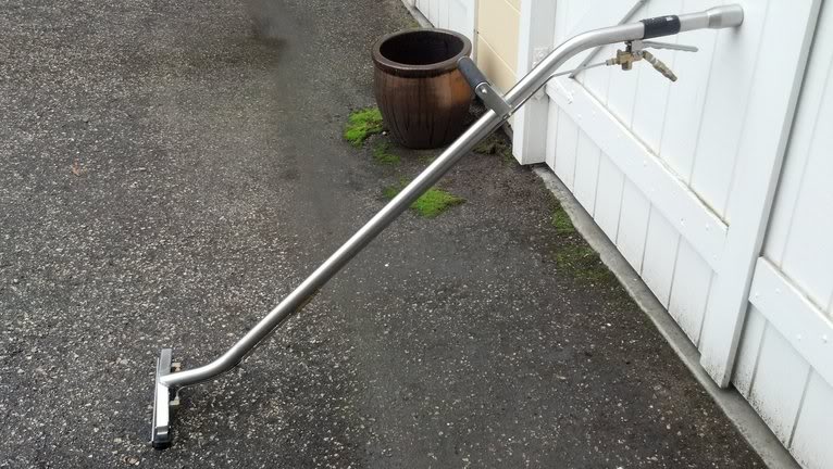

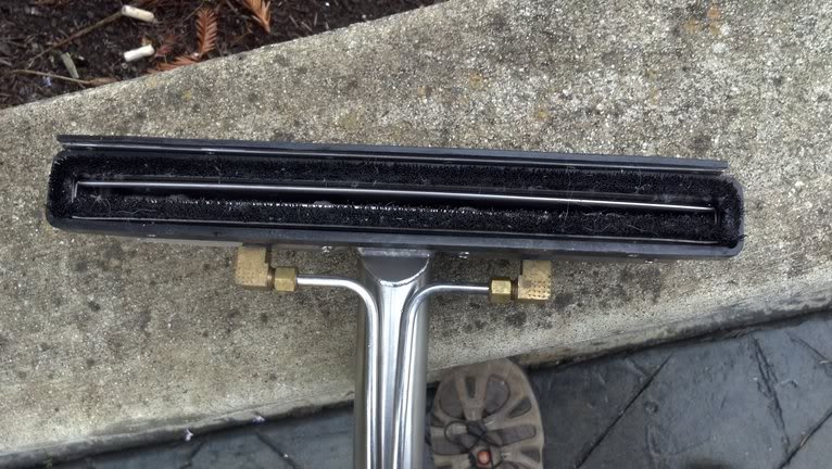

Ben almost every wand company sells hard floor wands. Most have a squeegee or a brush ring option, the PMF that I have has both..
Westpak, Prochem, Gecko/Interlink and Turbo Force all sell one similar.
300 to 400 is all you need to clean wood, vct, laminates or any other non porous surface.
Grouted floors, stone, concrete and the like need more pressure but there is far better chance of streaking.
Work quick, dont let the cleaning solution or the rinse water sit for more than a few minutes. PITA with out a helper.
I think that's when I bought mine. :madd:
