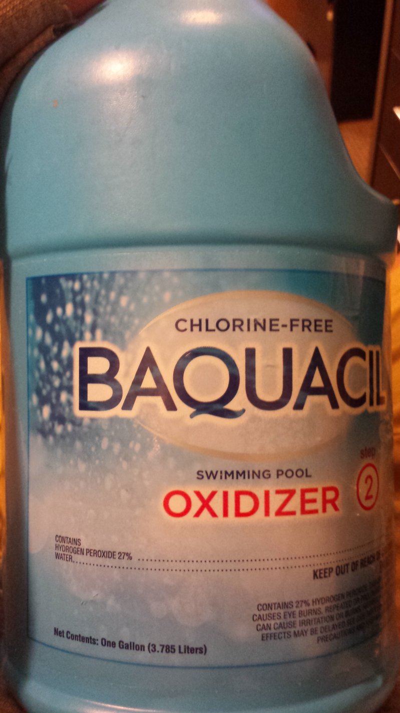

I use liquid 40 vol peroxide if I want to bump it up.
But yeah that powdered stuff should work.

Volume 89 for me..
15,251
BAM! would think that would be kind of dangerous to use?

Just mix as needed.. I have been using for a year or two now.
