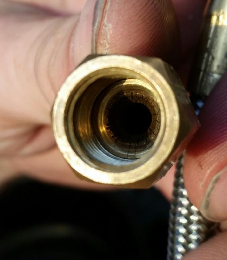

We had this off when we fixed the Cat last weekend so were fairly surprised to have it pop a leak today. it's connected to a male flair nipple on the GP Chemical pump right off the Cat.. The other end two feet away threads to the GPH meter shut off valve. That end looks like new.
Pulsation from the pump cause all them cracks?

If you have a toolbox of plumbing fittings it's easy to have a hairline crack or stressed fitting get "recycled" back into the box instead of being discarded, especially if it's "pretty".
Are you sure it was a NEW fitting? (speaking from my mistakes)

the only time I have seen that happen is if they get over tightened....to much torque spreads the brass.......

Yes, it's the original hose and fitting on the AT.
Possible , quite possible, my ham fisted employees are the culprit.

Just did the same thing myself on Friday replacing all pressure hoses one of the trucks, it happens to all of us at one point or another from not paying attention and over tightening.

we have not had any repeatable failure of flare fittings but we DO NOT REUSE A BRASS FLARE FITTING ONCE IT HAS BEEN BEEN REMOVED FROM THE TRUCK TO SERVICE ANYTHING.
we just use a new brass flare fitting and actually try to use same for all brass fittings when possible, as 10-25 dollars in new brass will save many headaches down the road. pay a little now or pay a lot latter, we pay a little now.
