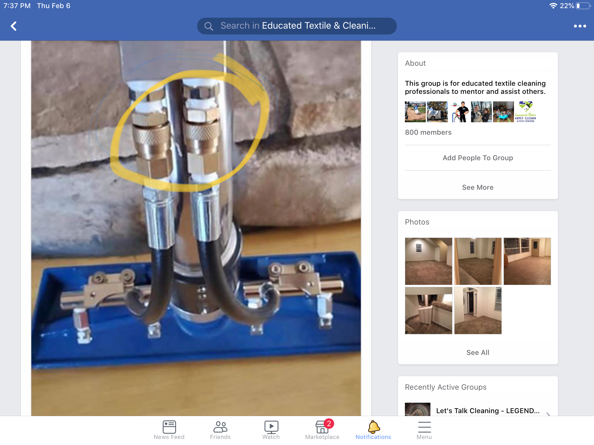

Feb 6, 2020 #1 SamIam Member Joined Aug 9, 2012 Messages 11,569 Name sam miller My dev 14 has a bad leak in the brass water area quick connects need to order more quick connects messaged Tom just wondering if these are available anywhere??????
Feb 6, 2020 #2 SamIam Member Joined Aug 9, 2012 Messages 11,569 Name sam miller Thats a dang wand not a tom wand and its not the wand with the leak used for illustration purposes only.
Feb 6, 2020 #3 Cleanworks Moderator Joined Oct 22, 2012 Messages 28,280 Name Ron Marriott Try pressure washing outlets. Looks like an open flow QC. Maybe even home Depot. Reactions: SamIam

Feb 6, 2020 #5 sassyotto Member Joined Jun 7, 2013 Messages 1,334 Name Paul any Parker Store should have those Reactions: rwcarpet and SamIam
Feb 7, 2020 #6 Lee Stockwell FOJL Joined Oct 7, 2006 Messages 18,851 Name Lee Stockwell Needs o rings Reactions: Hack Attack
Feb 7, 2020 #7 K KevinD Member Joined Nov 23, 2006 Messages 2,551 Name Kevin Dumas And some high temp o ring lube Reactions: Hack Attack and Lee Stockwell
Feb 7, 2020 #8 S scotty747 Member Joined Oct 19, 2006 Messages 923 If there open flow 1/4 inch home depot should have em. In a pinch sometimes you can flip em around and put the worn side down and the good side up.
Feb 7, 2020 #9 Lyman Supportive Member Joined May 19, 2007 Messages 1,765 Name Lyman They are on the web site, $42 for two pairs. Reactions: SamIam
Feb 8, 2020 #10 SamIam Member Joined Aug 9, 2012 Messages 11,569 Name sam miller Lyman said: They are on the web site, $42 for two pairs. Click to expand... Thanks I found it needed a new slot glide too. Is there something in should do to make these brass disconnect last longer? Wd40? Last edited: Feb 8, 2020
Feb 8, 2020 #11 Lee Stockwell FOJL Joined Oct 7, 2006 Messages 18,851 Name Lee Stockwell Parker makes a lube for o rings. A high temperature lithium grease will work too. Reactions: Hack Attack and Small town janitorial
Feb 8, 2020 #12 Shane T Member Joined Nov 7, 2006 Messages 1,663 Name Shane Tiegs I prefer SS male connects and brass female.
Feb 8, 2020 #13 Rob Grady Member Joined Jan 31, 2016 Messages 635 Name Rob Grady Superlube. Either in a spray can or grease in a tube. Part of regular maintenance. Reactions: SamIam
Feb 8, 2020 #14 BradFenstermaker Member Joined Oct 9, 2006 Messages 1,846 Name BradFenstermaker Northern Tool has open flow QD. Stainless too Reactions: SamIam
Feb 8, 2020 #15 Lee Stockwell FOJL Joined Oct 7, 2006 Messages 18,851 Name Lee Stockwell Because the couplers are NOT repeatedly uncoupled there is likely very little metal to metal wear. It's all o rings. Reactions: SamIam

Feb 8, 2020 #16 SamIam Member Joined Aug 9, 2012 Messages 11,569 Name sam miller I ordered new ones from the website I also needed a new slot glide for my 14 inch dev
Feb 9, 2020 #17 K KevinD Member Joined Nov 23, 2006 Messages 2,551 Name Kevin Dumas 3 oz. O-Ring Silicone Grease Tube Reactions: Lee Stockwell
Feb 9, 2020 #18 S scotty747 Member Joined Oct 19, 2006 Messages 923 Wd-40 will swell the O-rings. I use wd-40 ptfe dry lube or any silicon lube. Reactions: SamIam
