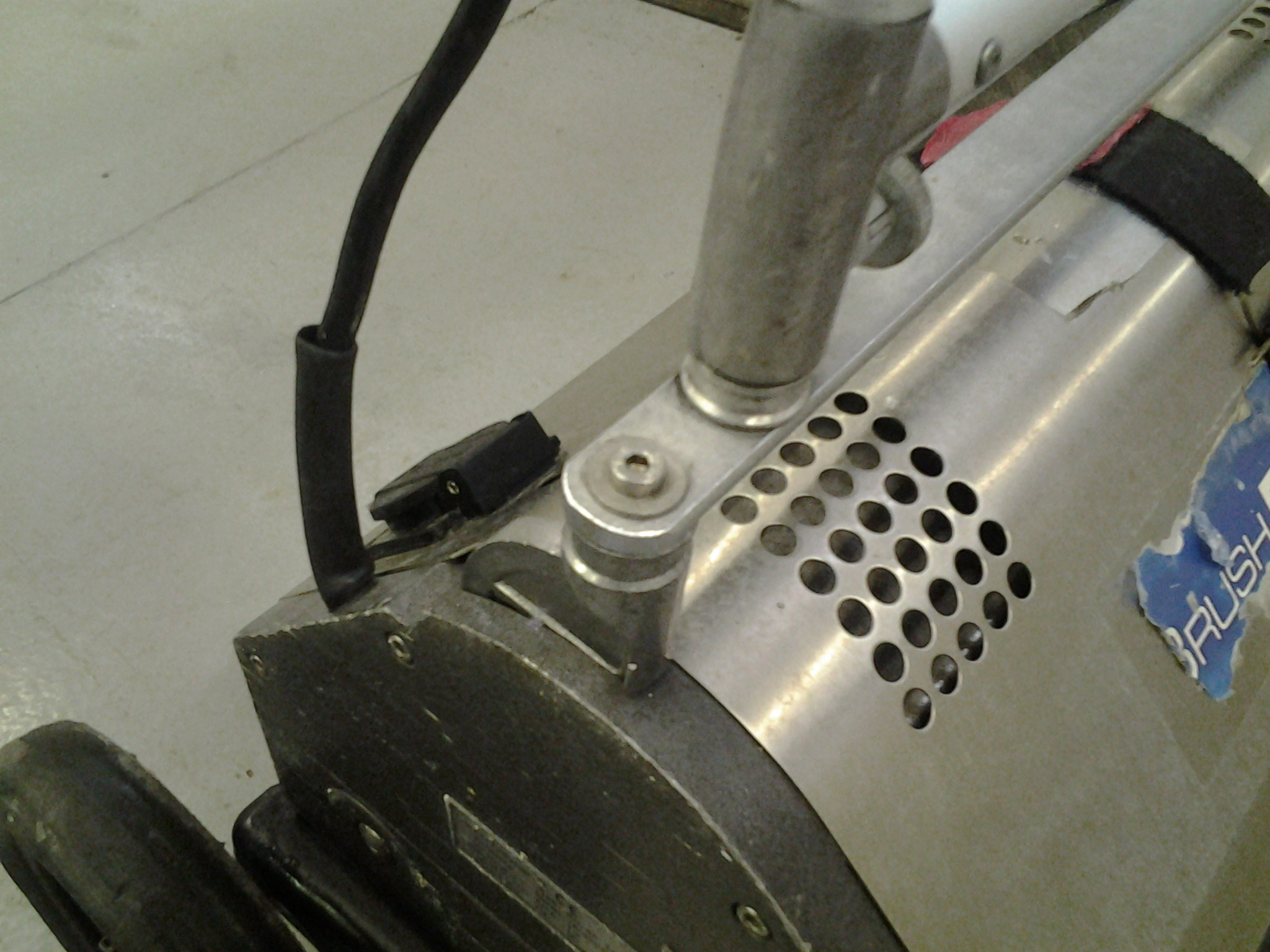

Here's some photo's of this connection:

sorry Jim I've been trying to upload other photos but it is so slow. The picture you see here is the original screw and that side is good. On the other side the screw head broke off flushso we used a back out to try and move remove it all and it snapped offso then we were left with drilling it out which made the hole bigger then we made new threads for the new screw. The challenge is that the metal is a pot metal and it is very soft so the threads just keep ripping. It did hold for a while but eventually did not hold. So the other day we put a metal spacer for the screw to tighten into but it too eventually pulled out. I thought about redoing it and apply some type of super adhesive to hold everything in there. Its a very bad design (weak point) for a machine that works great.

I figured it was a pot metal that's why I was asking if it had to be removed at all....If not...then if there is enough area do as mentioned above and insert a helicoil into it...but because it is a light weight pot metal you will have to use something like a JB weld to help glue the helicoil in because it will start to work itself out if you don't......
If there is no room for a helicoil.then use the same trick with the bolt...just rub JB weld onto the threads and tighten it down and let it set over night....
with this type of metal this is the best chance you are going to have...
