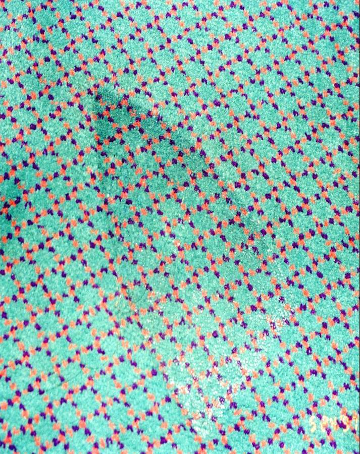

Here are a couple of examples of my work
before, a hot plate of some sort was dropped onto the carpet and burned the fibers badly

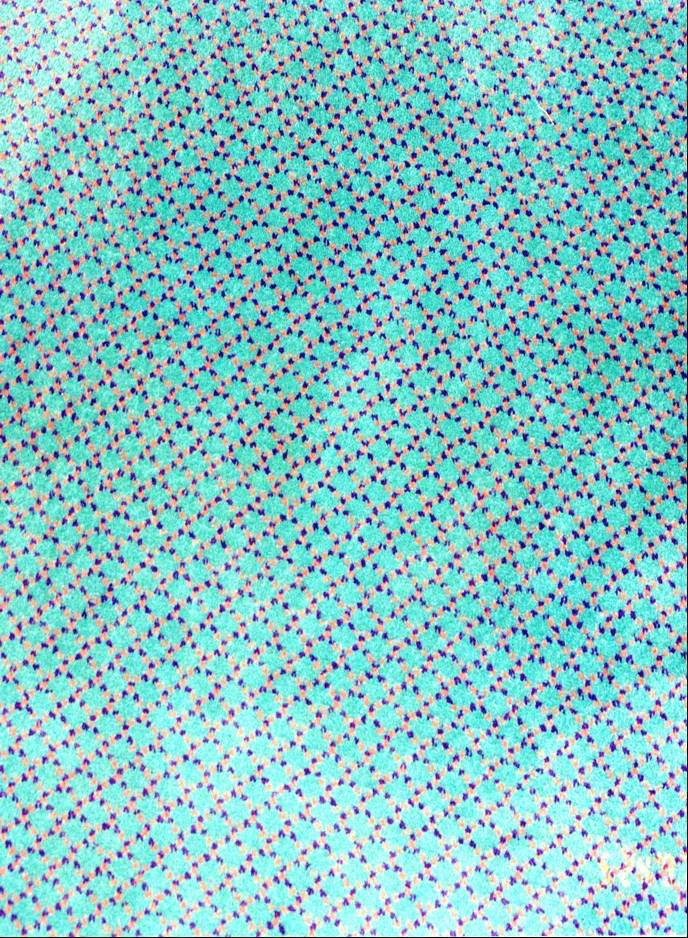

after

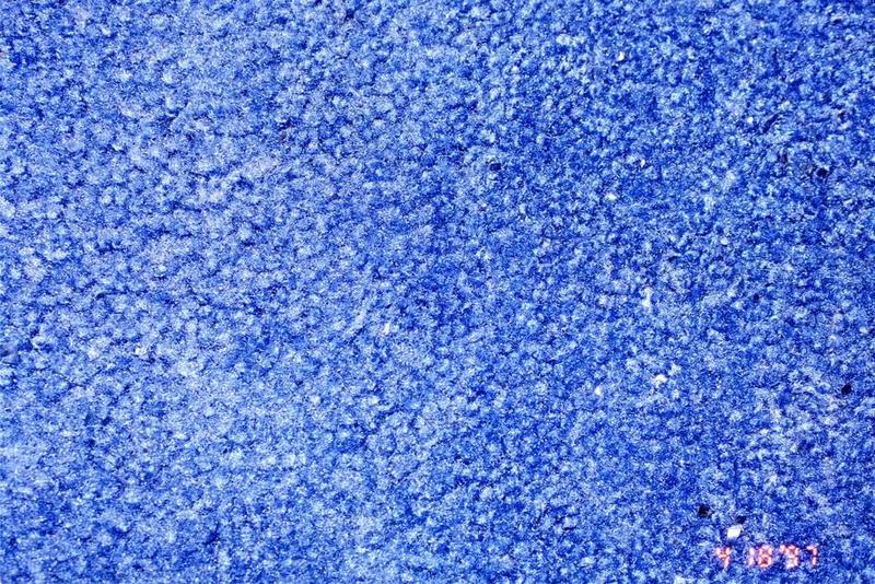

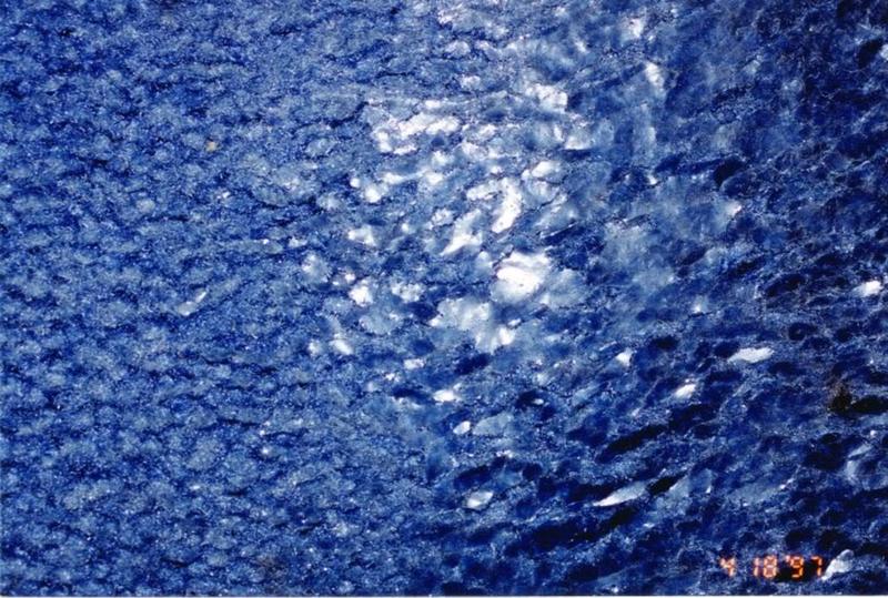

before

A lot of burns are really superficial, some are quite deep but most are not as bad as they seem. I have taken then out that were superficial as well as deep, look at the blue carpet, that is a fairly heavy melt. I guess a lot of things are like Tony always tells us, to think outside of the box.

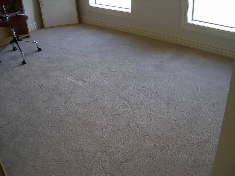

I have the occasion to do some of these, and often get very good results.

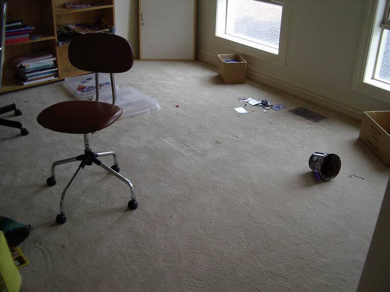

This one was colour that leached out of a piece of dark felt. It's over between the windows

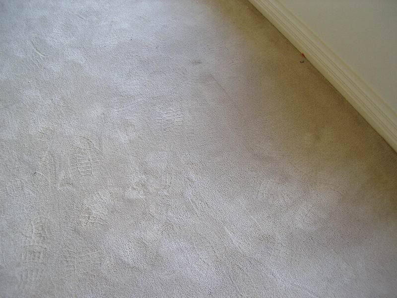

After cropping
Bit closer
This was a newly constructed house, roof leaked in a severe storm, carpet was restored but this mark remained.
Builder was up for the entire house replacement because of this mark.
It's the fastest I've ever been paid by a builder :shock: :lol:
